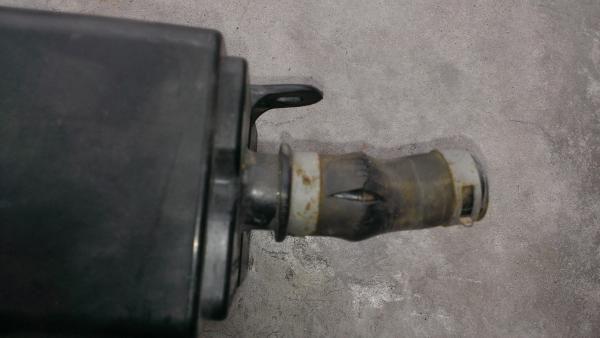

It is worth checking this hose for cracks. Common failure point.

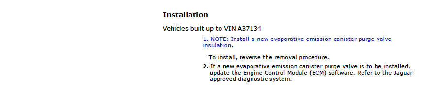

Also, there is a new tube/filter/mounting necessary that does not come with the valve if you get a new one. Procedure
http://www.jagrepair.com/images/TSB/XK8/303-63.pdf
Part numbers at bottom of the TSB above. You can find the tube at your nearest auto center. This basically feeds another filtered air line into the brake booster box above the wheel well. The filter is installed in that box to one of the bolts.

Originally Posted by crbass
I'd do the electrical checks first, but if you do need to replace the EVAP valve, I haven't found it necessary to remove the wheel, just turn the wheel in and take the wheel liner out (5 minutes). There is enough room to access behind the wheel.

So It looks like my evap has been replaced, However the extra filter has not been done on top of the EVAP. Are you saying that filter needs to be put in place in order for the EVAP to function correctly?
If it's the new part, likely the only thing the lack of filter would do is to put potentially dirty air into it. No, the problem will be if your ECM has not been updated, it will not know what to do with the new part.
Old Feb 9, 2020 | 07:23 PM
perfectphoto's Avatar
Joined: Mar 2011
Posts: 149
Likes: 69
From: San Luis Obispo
Is it dealer only to update the ECM? Can you explain more as to why the ECM needs to be updated? I have power to the ECM and it seems to running and moving air. It seems to be a simple on or off part. Thanks for the help, I very much appreciate it.
Old Feb 9, 2020 | 07:58 PM
crbass's Avatar
Joined: May 2019
Posts: 1,092
Likes: 927
From: Durham, NC
Again, depends on the part. If it is LJG1515AA (all used at this point), you don't need to do this. If it is LJG1515BB, you do, according to the workshop manual below. No, not necessarily dealer only. In theory, anyone who has IDS can do this, probably independents around you. That said, one of mine did not need this, but I assumed the ECM had been updated when the engine was rebuilt long before I bought it.
From third edition of XK8 workshop manual.
