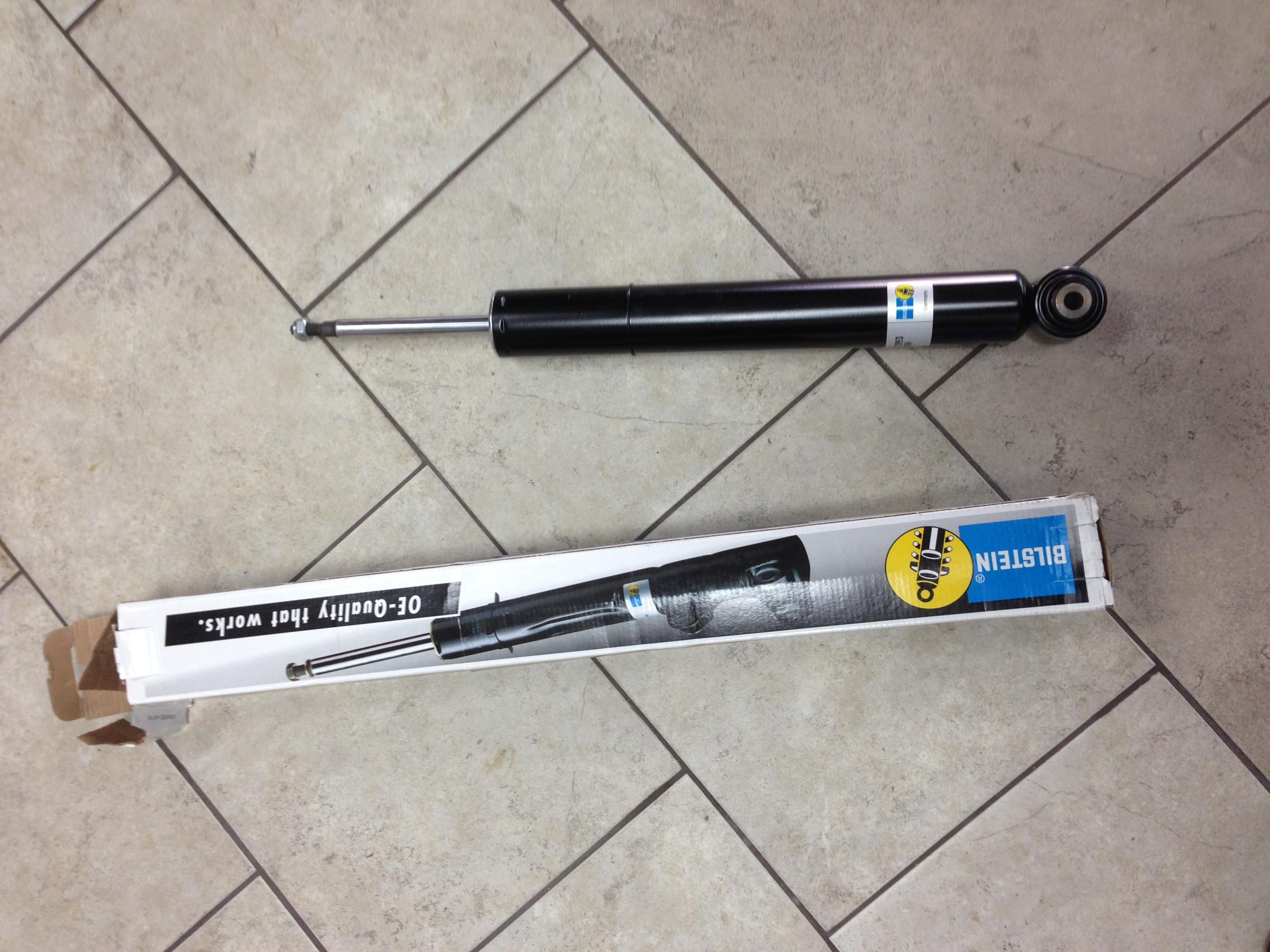

The shocks are coming from FCP Groton/Euro. Jaguar Shock Absorber Front (XK8 XKR) - Bilstein 24-067263 | FCP Euro
Hopefully they won't be on back order.
The lower bushings were a pain in the neck to find. I was going to get them from SNG Barret but ended up getting them from different Ebay suppliers. I couldn't find one supplier that had both bushings. One set is Meyle and the other is URO, which I hear is not the best quality. I'll check how it looks when it shows up. The lower bushing numbers are MNE1360BB and MNE1360CA.
That's a good price on the shocks. Think I'll call them and see if they are in stock as my vendor told me today it would be another two weeks before they ship.

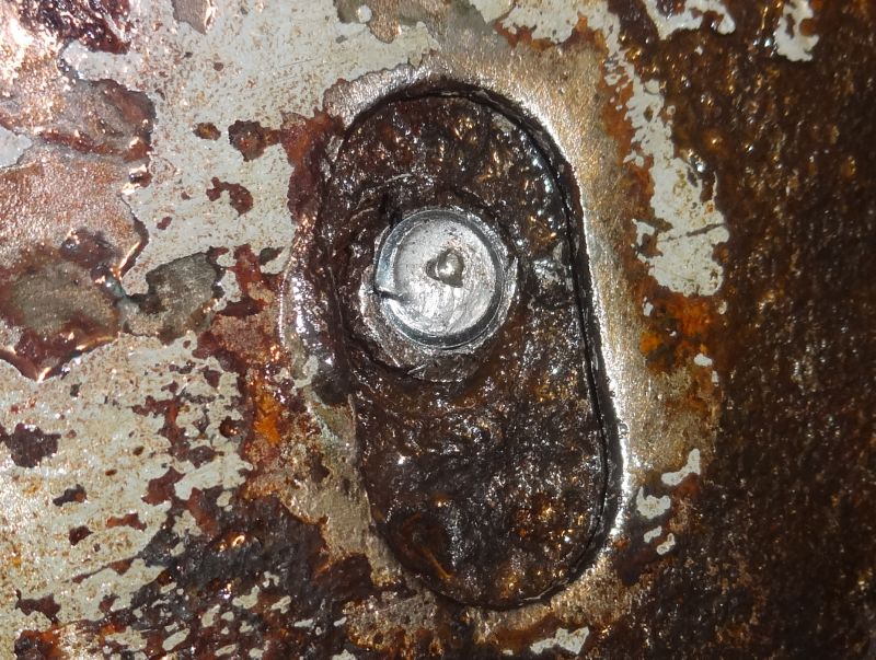

The bolts will not come out, the problem is they are quite long and will be very badly rusted beyond the captive nut in the box section. You have a couple of options, dill out what is lift of the bolt and retap, or cut out a part of the box section and weld in a new piece with new captive nuts.
I tried drilling out the old bolt, I then taped it to a smaller size and screwed a smaller bolt into it in the hope that I could then screw the old bolt through the captive nut. However the end result was that the new bolt sheared off, so the old one was clearly not going to move easily.
Drilled and taped the inside of the stuck bolt.
Started to tighten up the new bolt,
Back to square one!
After more drilling the captive nuts broke free from the inside of the box section, they looked like this. That is the top of a broken drill bit poking out the top.

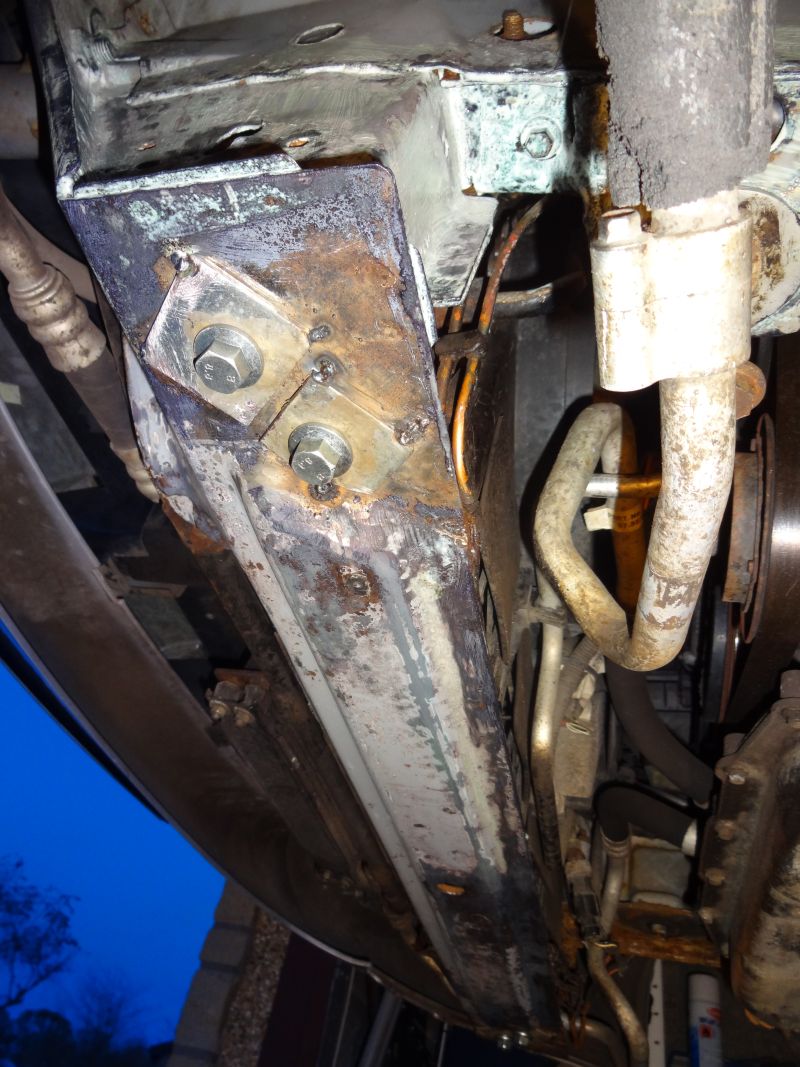

Plan B
Cut out squares from the box section.
Make up some captive nuts.
Tack weld them into place and check for fit.
Then fully seam weld them up.

John55, Sorry to break the bad news to you, I called FCP Euro to see if they had the shocks in stock and they do not. It appears they are a parts forwarding house and actually order from other vendors. Anyway they could not give me a ship date either.
Soooo, I'm staying with my original vendor who said yesterday a week or two, wonderful world of sourcing Jag parts.

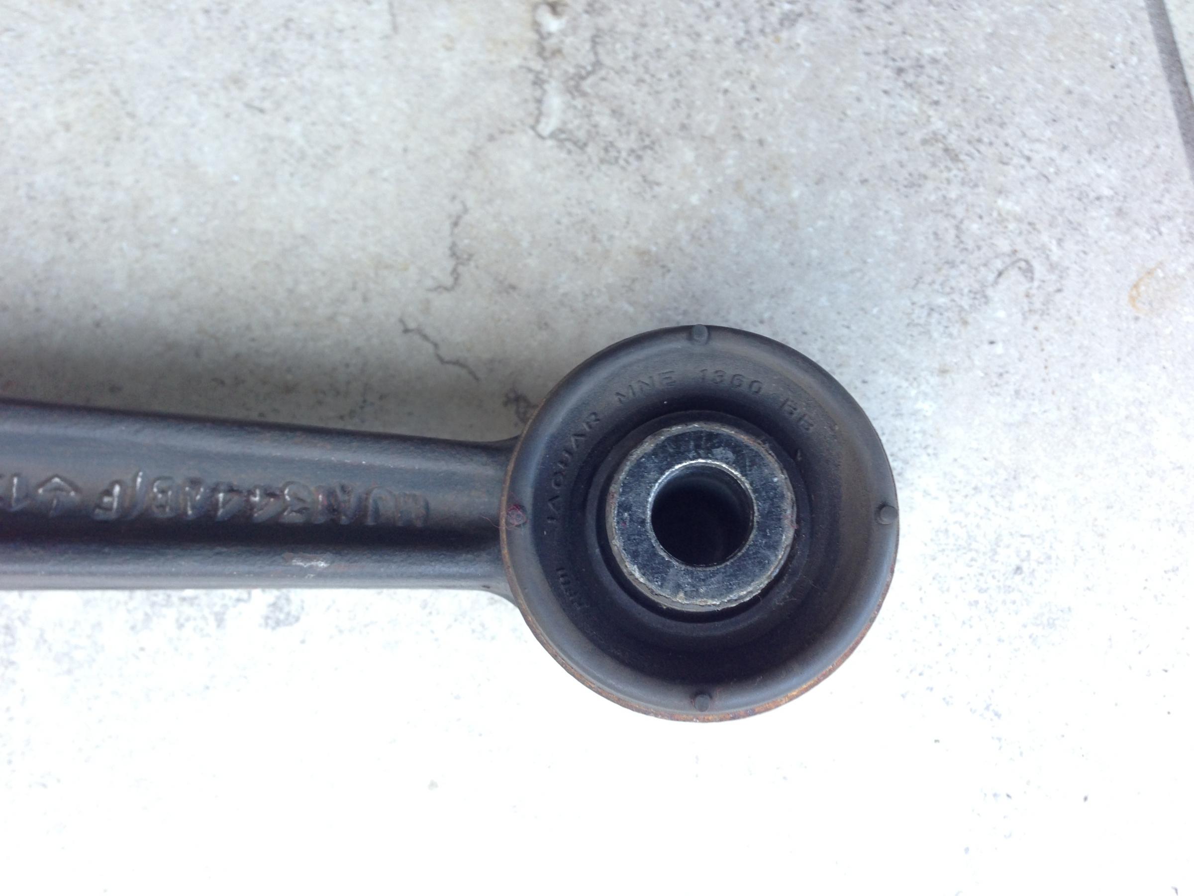

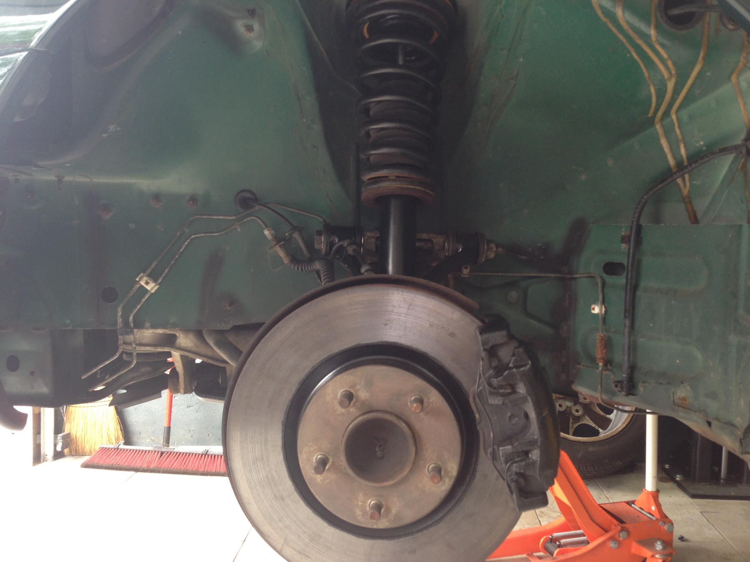

The suspension is going back in. Here's a shot of the right side installed. I painted the Rotor and the calipers while they were off. I also painted all the control arms with a black epoxy paint. Just waiting on a pair of inner tie rods to finish up.
My lower control arm bushing looked almost new. I ended up not changing those. Much more to do. I still have to drill out the broken Xbrace bolts, change most all coolant hoses including valley hoses, thermostat housing, coolant overflow tank, and water pump. Tensioners are here to be replaced. Transmission fluid and filter change. Some interior work and then a respray. I have a headache just thinking about it. I have not had much time because of work, but I must say, I am enjoying the frustration of getting this car in top shape.
