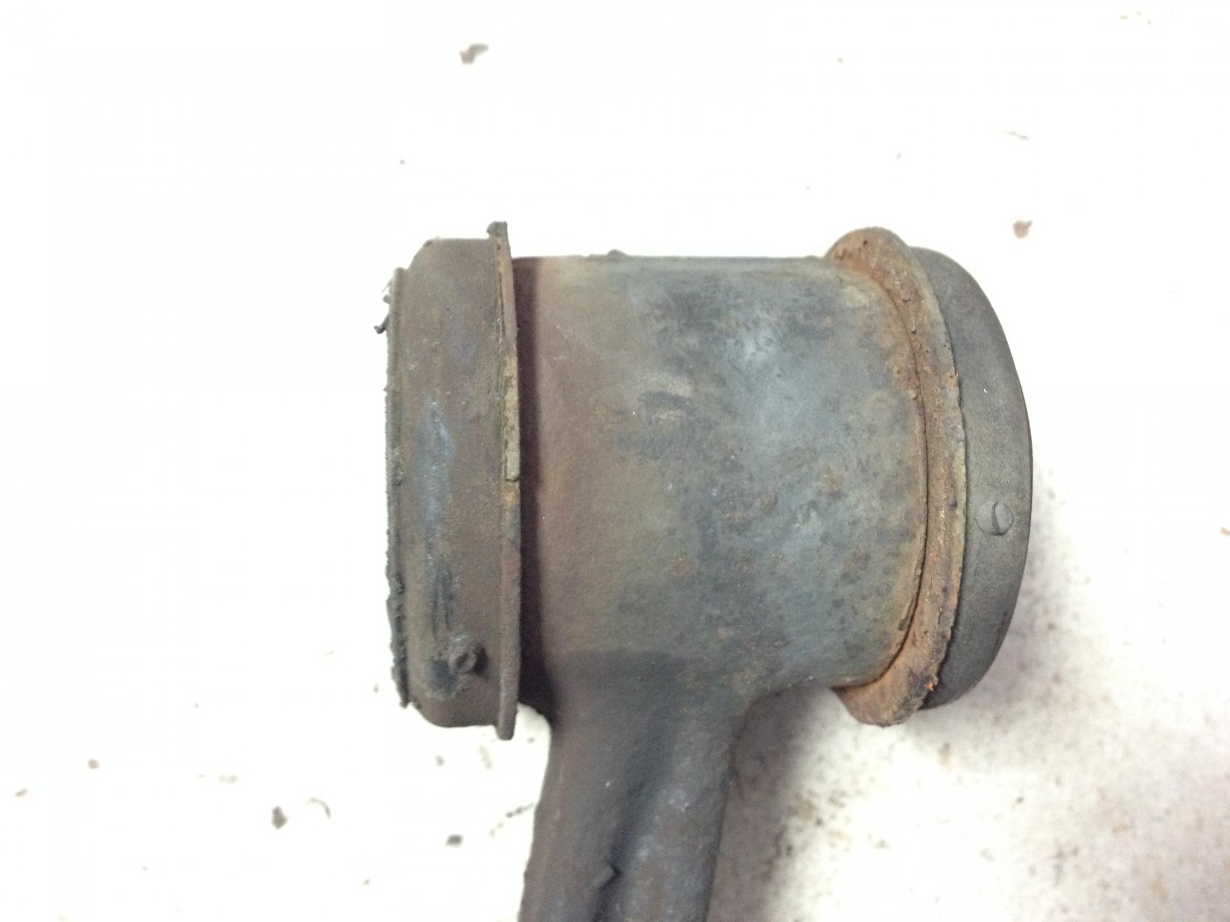

You know, since I'm going through all of this, I'm wondering if I should just replace all bushings and ball joints in the front end. The shocks are not leaking, so maybe leave that. I'm not sure. The car drove fine except for for clunk and a shaky feeling in the steering column. I was hoping that was because of the bad upper ball joint.
This is what the upper arm bushings look like. What do you think?
Attached Thumbnails New to me XK8, now the work begins-img_0754.jpg   New to me XK8, now the work begins-img_0755.jpg
Old Jun 14, 2014 | 03:05 PM
Posts: 25,873
Likes: 4,710
I would
