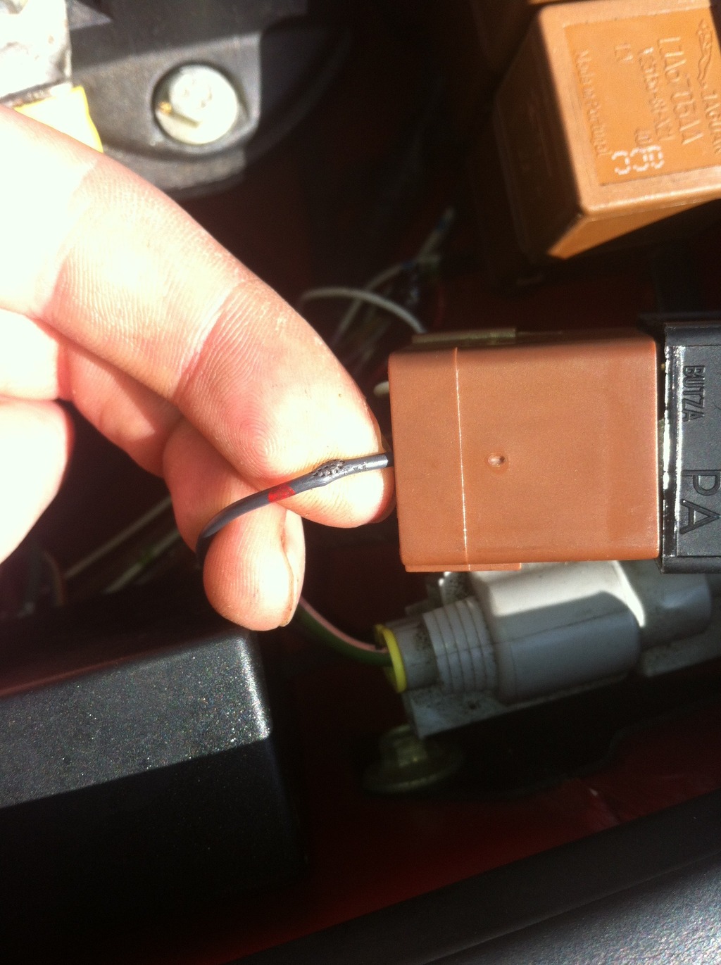

Ok. I ended up taking half the day off here to look at this unit. I got myself yet another pricey scanner. I had to update which took a while. Then I hooked it up went to read the DTC's. no communication with the ECM. Pissed off at the world. I went through the scanner and found I could read the TCM and ABS modules. Codes I got p1797, p1632, and u2500 (can bus no communication with ECM). Bonus I had some where to start. Hit the search function and got a lot of weird responses. I mean weird "fixes". One kind of caught my eye that so simple and easy to try. I figured why not. I've done worse things in my life. The suggestion was to unplug the relays under the hood located near the ECM and plug them back in.
I did that and BAM instantly everything on my dash was gone except the CEL. went to plug my scan tool back in and still no communication to ECM. I made some progress though. I decided to unhook the battery to hopefully reset the mystery CEL. Hooked it back up. People on here are saying no communication leads to ECM replacement at $6000 (this thing would have undergone an LS swap before that).
So. With those 3 codes in hand and the mystery cell. At a loss for words as to why i couldn't get communication, dreading a dealer visit. I went and took a picture of something "odd" that I noticed in the relay blocks under the hood. There was one relay that had been replaced. I was literally going to take this picture ask what this relay was for and leave it at that.
Before I did that I figured what the hell. Unplug it again, plug it back in and see what happens. When I went to unplugged it the 2nd time the relay holder popped off its clip. I laid it sideways to get a better up to separate. Found this.
After plugging the relay back in. Figured, one more time look for communication to the ECM. Sure as the sun always rising in the east I HAD COMMUNICATION. Code came up as p1121. I still need to repair that wire. But everything in my 5 min test ride after performed perfectly.
I am going to take it on another little cruise here about 20 mins to get some premium fuel for her and will post back here if I find anything or p1121 comes back.

Great find and I hope that fixes that problem. However, I do see new upper shock mounts in your future.

Well everything seams to be ok. Drove it around for a good hour with a few stops along the way. Car is gonna have thurough front end inspection tomorrow. Noticed a slight clunk in the front passenger side and a slight uneven tire wear on the front passenger side that I never noticed by feel (physical tough) when I looked at it before test drive.

Originally Posted by Gotts2bme
Noticed a slight clunk in the front passenger side ...
see that upper shock bushing in your picture of the relay panel.

Hi.
That chafed wire looks very suspect. Somebody may have been there before.
A member in our English sister forum changed his TB after a P1121. Failure code returned.
Turned out to be a bad TB pwr. supply relay.
