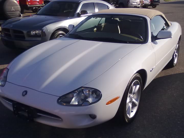

Greetings everyone! I wish I found this board before I bought my 97! Owned the 97 Xk8 2 days and wish I could drive it:
Purchased 97 XK8 w/74500 miles. VIN SAJGX2741VC012714. I am 3rd owner.

I've driven the car about 20 miles so far and it was a blast! Cant wait to get it back from the shop! Let me know what your thought are on items in my post. Look forward to many years of fun in my new old XK8!
