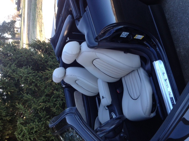

Now I may be of service to you! I ordered new seat covers from topsonline and had the customized with black stitching on oatmeal leather. They came in and looked great quality and since I was pitting in a black interior, the color wasn't an issue. That being said, I had originally ordered the black but the texture and the color was actually off, hence the decision to do a contrast color.
I took em to my trim shop and he called a day later and said, "I want you to see this seat before I finish"
The covers were saggy, pulling and basically looked like crap. I was so upset. When I called topsonline, he said it wasn't his covers but my seats that had the issues due to the age. Essentially the foam had been mashed all these years.
Well, I had my trim shop add 1/2" foam and, yes, they finally fit, but were fatter and bigger than before.
I have to say, once we did that, they were amazing and it was like a new interior and the seats were really firm and supportive, BUT!!!!! It cost me an extra 200 installation. Something I would have considered had I known.
If you want them tight and smooth, add foam. new seat covers / please advise 97 XK8-image.jpg

I know nothing about uphoslstry but would some heat from a heat gun help with the wrinkles?
