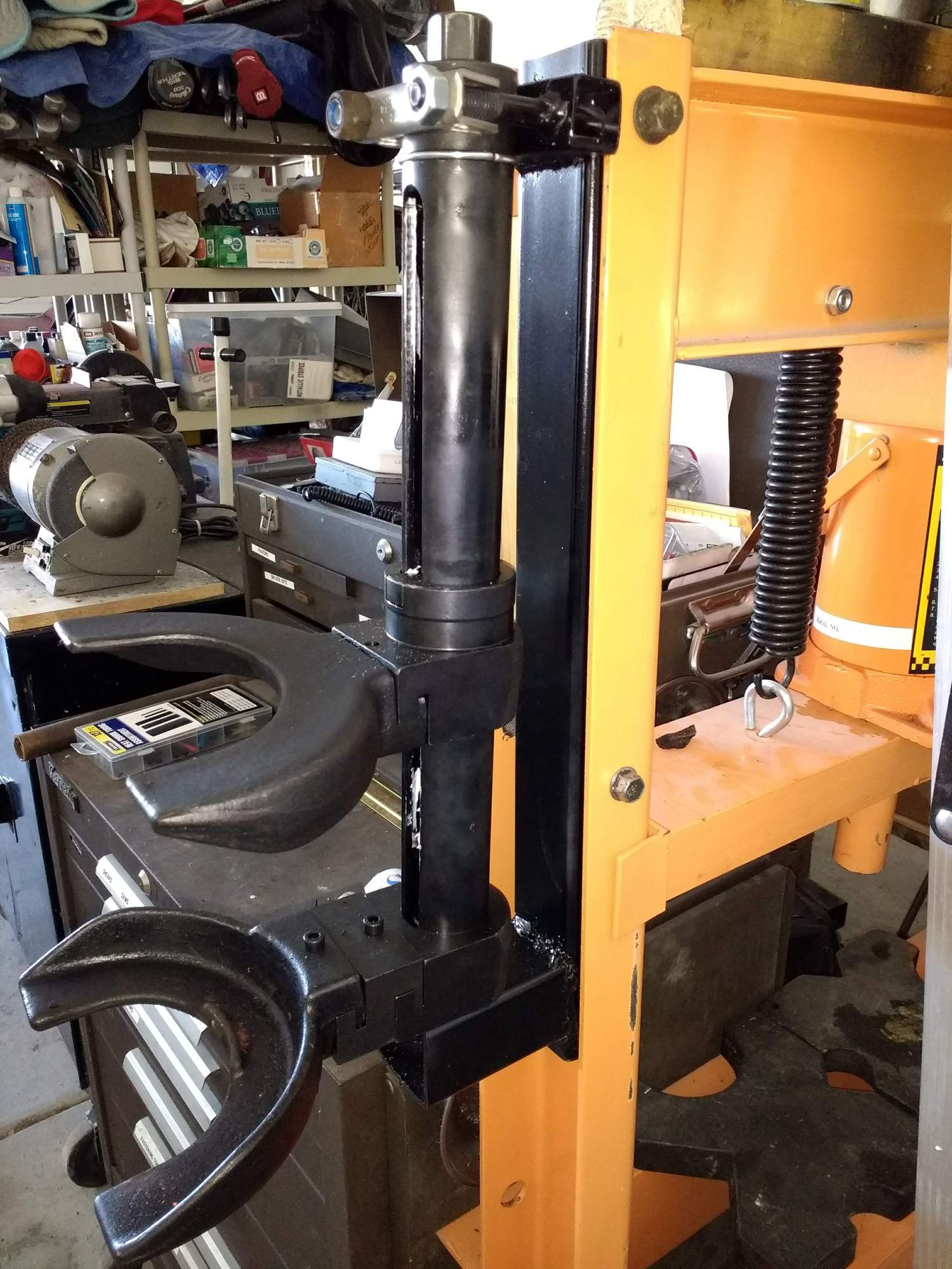

Update: project complete. Replaced the front upper mounts, bump stops, gators, and shocks. Took about 4 hrs , but some of that was learning time for the new Strut tool I purchased ( referenced in post above). Vern was going to loan me his tool, but shipping costs were prohibitive. Upper mounts were totally collapsed, as were the bump stops. After assembly and test drive, measured fronts at 15.5" each side. Rears also at 15.5". Not quite to spec, but close enough,and much better than the 14.25" I had previously. I did use 2 lower spring isolators, which only gained me about 1/8". Probably not worth the extra money.
Lessons learned. I tried removing the driver's side inner fenderwell, as it was reported that doing so would eliminate the need to disconnect the upper A-arm. I tried for about 1/2 hour to get the strut out, but found no way without removing upper strut bolt. Finally just went with the traditional method. The Tip about keeping the orientation of the Mount, shock and spring is a good one. Use a marking pen and make plenty of reference marks before disassembling. The strut tool worked well, but took a little work to make fit. The spring spacing is a little tight to get the lower bracket between the springs. Finally found I could insert the bracket a little higher, and then rotate the strut assemble to "screw" down the position of the bracket.
Using the tool, with the strut, made for a pretty heavy lot to control. I made an adapter so I could mount the tool. I mounted it to the side of my 20 ton press, but it could me mounted to a wall, the side of a toolbox, etc. I made it out of some 2x2 box tubing i had laying around, but it could probably be made from 2x4 wood with some metal angle iron for the bottom brace. The tool sits in a hole at the bottom, and is held in place using a 1 5/8" exhaust clamp at the top.
Strut tool with bracket, attached to 20 ton press
