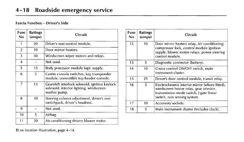

I noticed there is no fuse in the #4 fuse location on the left (passenger) side facia fuse box, The fuse list I found shows this is for the airbag.
Looking closer, it does not appear that this is actually a working fuse location, which makes me wonder if my fuse list is the right one.
I am missing the boot/trunk fuse box lid that has the listing for all the fuse boxes and locations.
Can anyone offer some insight?

The Vehicle Care Handbook for the US specification 2001 XK8/XKR is JJM 18 16 14/20. It shows fuse #4 as Not used.
