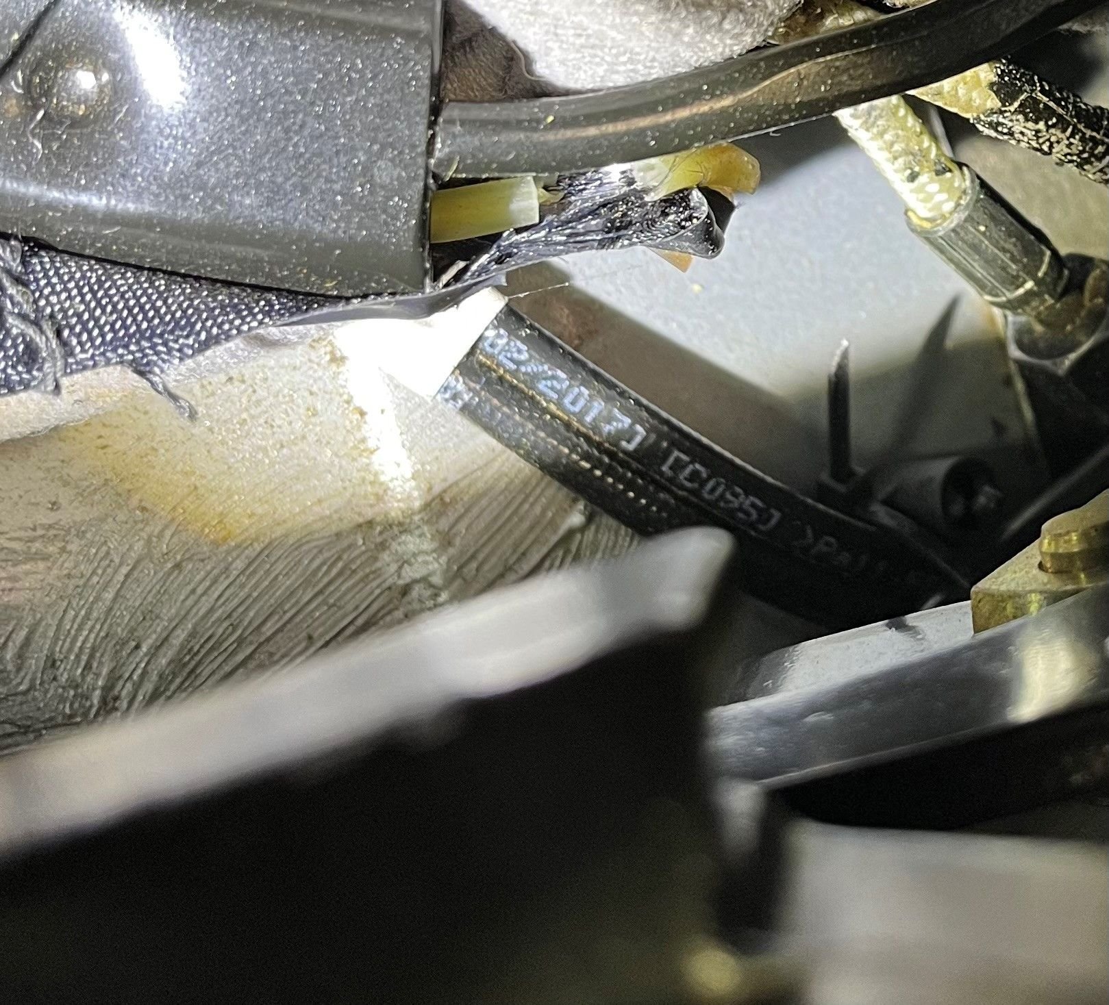

After replacing the front shock mounts on my new to me 2000 XK8 convertible, the next item of concern was the hydraulic lines to the front latch. Looking at the pump, the linse for the lift cylinders are obviously OEM and show the expected level of deterioration. The lines going to the front latch however don't have the black covering deteriorating like the others and there's a piece of blue tape on one, as if someone was identifying one line. Looking down from the right side of the car, I could see the lines and spotted a manufacturers date code of 02/2017 so that settles it...the prior owner had those lines replaced. Needless to say, I'm thrilled that job is off my worry list!!
