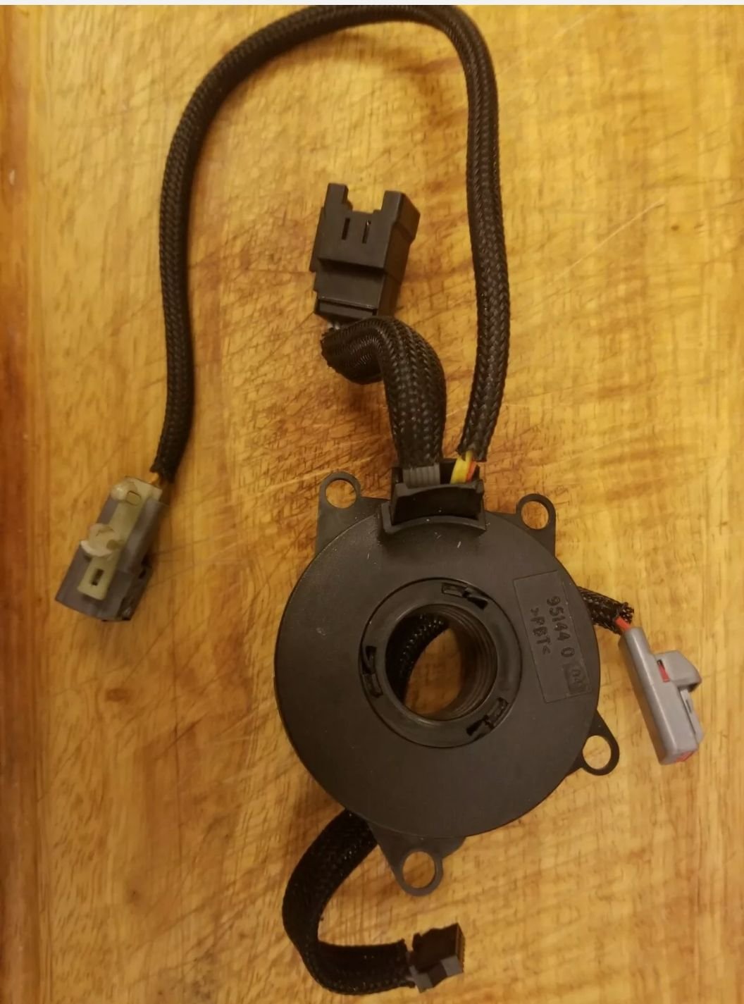

Ahhh, ohhh, that clock spring...! That's right! The one with the band wound up inside, yes??? I had forgotten about it and, I'm sure it's separate from the stalks.... Pretty sure. Fiddly and a pain in the butt...
You're a better wrangler than me if you found that wheel face to be a snap. I get frustrated with stuff like that, in tight spaces and angles.
I hope that this IS the thing that is causing your problem!
And,,, be careful with that ribbon in the clock spring. I don't remember how/if I had damaged mine or how the issue with mine came about but it is something that I had to replace way back in the beginning in learning about the XK8... It wasn't the easiest find hunting the web...
Old May 21, 2021 | 05:24 PM
JayJagJay's Avatar
Joined: Sep 2016
Posts: 4,277
Likes: 1,314
From: New York New York

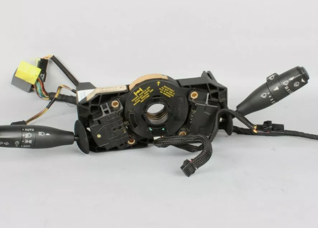

You know what, Man...
Just in case. Crazy me I found the example photo and didn't think to throw up the link for the results that came up on eBay... This is the whole assembly and if push comes to shove,,, well, you know...
Again, from memory. Be careful with that ribbon and all the do dad's. Theyz old at this point and subject to giving headaches...
https://www.ebay.com/itm/233989311826

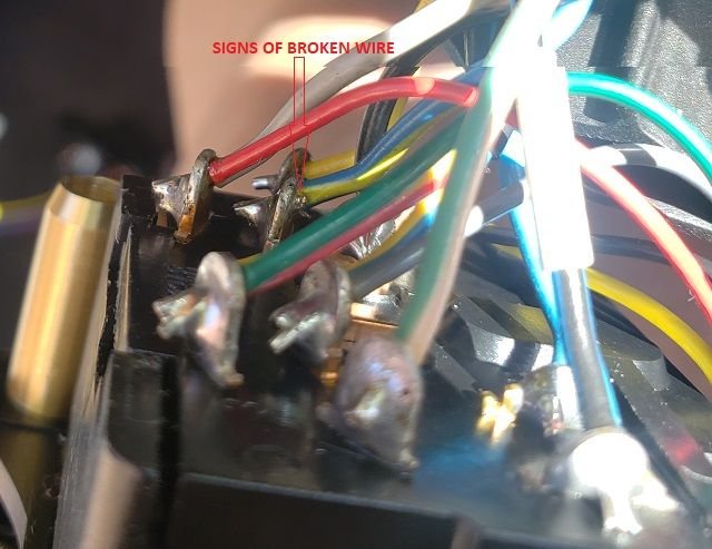

Took this switchgear assembly out and sure enough there is a broken wire (right at solder joint)
It is solid blue and comes from the turn signal stalk but there do not seem to be any other similar color wire??
Hope that one of you veteran can point me to where it supposed to be connected.

Do you have a meter to hand that can measure resistance?
If my logic is functioning, I think that adrift blue lead will short to ground in the 'dip' position of the stalk

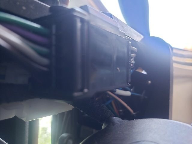

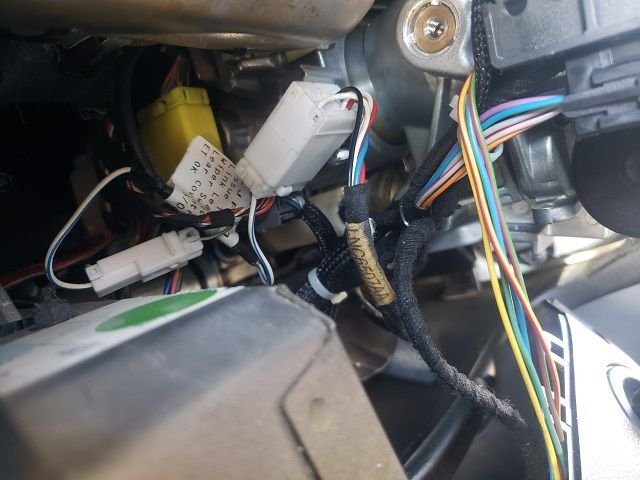

Study the electrical drawings, but could not find where in hell this ble wire goes to.
additional forum search said to connect to an Orange wire?? none t be seen around the stalk..
went back to car for a 6th look and closeup of each connector and finally found a small piece of bare wire protruding from a connector with a " Blue/ Yellow" wire attached.
Length of that blue wire barely reaches it. so that would be best logical bet
Reroute this Blue wire so it is not so tight and solder it back.
Put all back together, test..... VOILA !!!
I have lights again

Well done. It is the 'dip' wire from the light switch stalk. Unfortunately, the colours from it don't quite match the electrical diagram:
