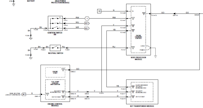

A P1251 won't prevent the car from cranking.
It could be an issue with the rotary switch as Stogie25 notes (try starting in neutral), but there's more going on here so you can't eliminate the ignition switch at this point. The BPM ground signal to the starter relay is also fed back to the ECM, and this doesn't happen if the relay is simply bypassed.
You should be able to to get to the starter relay connections (in the RHS bulkhead compartment). Try grounding the Green/Orange wire - with the relay in place & ignition on - to simulate the BPM's action and report back what happens.

TBH that check was more curiosity on my part as it doesn't really prove much other than that (i) the BPM isn't outputting the ground signal to the starter relay and (ii) the relay and the power to its energiser coil is working OK.
I wondered if the car might start if everything else was in order other than the ignition switch. It may be that the BPM requires the ground input from that switch to respond properly.
There's quite a lot going on in the startup sequence. I saved this snip (4.0L cars) which I think is from one of the workshop manuals:
Passive Arming: Vehicles with Key Transponder Module (KTM)Engine cranking and starting are controlled by the ignition switch, ECM, BPM, P / N signal, key transponder module, ignition key reader exciter in the ignition switch, ignition key transponder and the gear selector not-in-park switch.
Cranking and starting are accomplished in the following manner:
Ignition key switched from the OFF position
• KTM receives a signal from the ignition switch position I as the key is turned
• KTM energizes the reader / exciter, which causes the key transponder to broadcast its security code
• If the key transponder code matches the programmed KTM code, the KTM outputs an OK TO START signal to the ECM via a serial data link
• ECM receives OK TO START signal and transmission P / N signal (hard wired from transmission), and enables fuelling and ignition
• ECM outputs a SECURITY ACKNOWLEDGE signal to the BPM via a serial data link
• BPM receives a park signal from the gear selector not-in-park switch and enables cranking if the security system has been disarmed
Ignition switch to position III (CRANK)
• Ignition position III crank signal is received by the BPM
• BPM grounds starter relay coil to energized starter motor
• ECM receives starter relay coil signal and sets engine starting values
It may be a security problem, but no sign of a P1260? Try one of your other keys.
Otherwise it's a case of eliminating any fault with the inputs to the modules, but the BPM isn't easy to get to. I'd start with the ignition switch -> BPM 'crank' wire (Red/White). A PITA but at least these are $0 checks.
ECM/BPM module issue would be down at the bottom of my list
edit: double check Fuse #14 (10A) in the engine management fusebox for the P0444 and P1251
