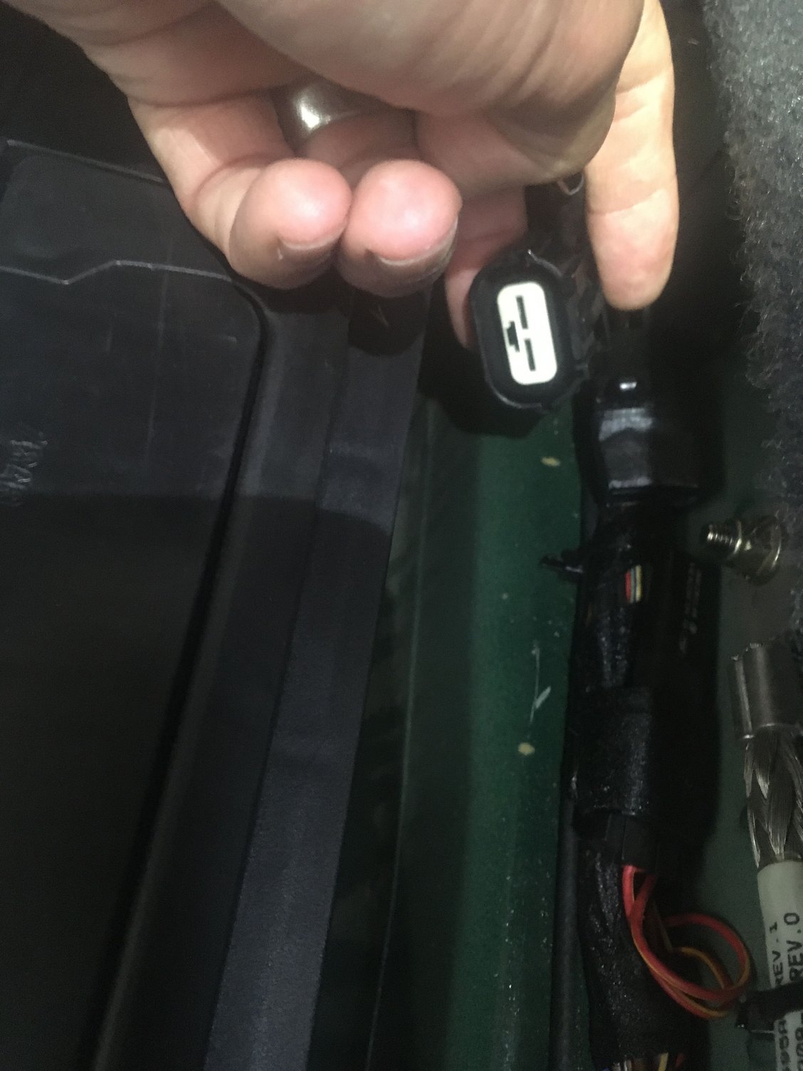

This is in the trunk by the battery. Any idea if it is related to the antenna issue?

^^ That electrical connector has nothing to do with your antenna. It was only utilized to maintain your factory battery during the car's transit across the Atlantic Ocean. You can tuck it away and ignore it....

Jon is right about the transit battery isolation device connector. Additionally, you may find another unused connector which is an acessory 12v socket which would require and additional relay. I use it to power my Sirius.
