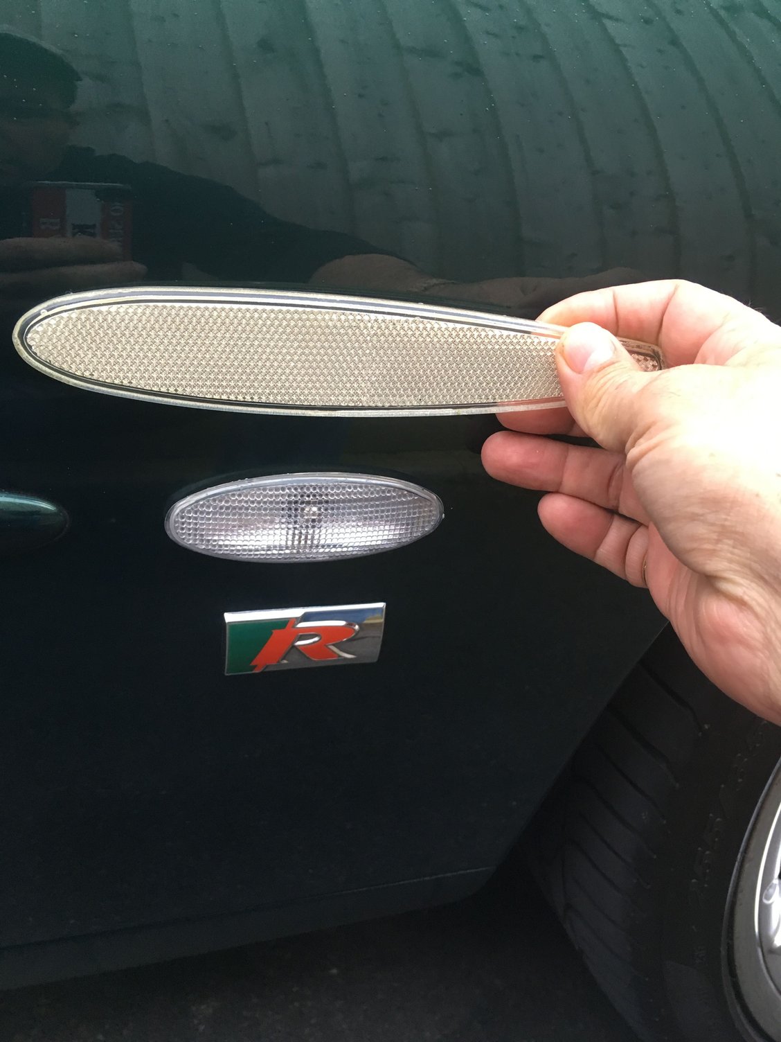

So, bought some clear side markers (front and back) last summer, to go with the clear side indicator lenses I had already purchased. Over the course of the months since I hadn't realised the change in 'clearness' of the 4 side markers. Hopefully the photo has uploaded and will be clear (excuse the pun) to see the change that has happened to them, compared to the still very clear side indicator lenses.
Ive taken the lenses off, left them on the house radiator for hours, used beach, degreaser, white vinegar all to no avail.
They don't look right now but at £80 for a set of 4 from Adamesh its not a cheap fix to simply replace.
Any advice on how to go from here?
Thanks
Jules

Another member had the same issue, RaceDiagnostic, he put them in the oven and they turned clear. Something about the layers on the aftermarket lens trap water.

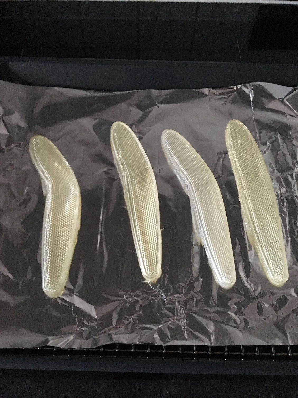

The result of being in the oven for 45 mins at 90'C!

Yuck. Oven too hot, I guess.
Seriously, at £80 a pop for 10 months or so of use, I'd be asking the vendor what he is going to do about it: they're clearly not 'fit for purpose'.
Did the repeater lenses come from the same source?

I checked at 30 mins too! It never cleared them either. Quite disappointed as have next week off work to go touring in her.
No, got the side indicators from an eBay seller as found a good price. Just ordered another set for £55 from 8ru XKZ on eBay. Hopefully they are of better quality than Adamesh's.

The vendor 8ru or XKZ seems to be same. The lens I got from them was very good. Perhaps a Heat Gun would have eliminated the "TOO LONG IN OVEN". Usually the guns have a Hi and Lo temp. Adhesive used was a Loctite clear insta-stick glue but it had a 2-3 min time to apply and place lens on housing.
