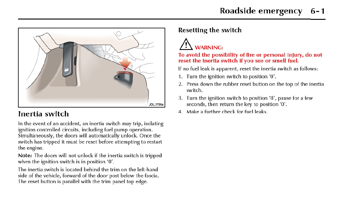

Can you tell where is the Inertia Switch?
Old May 9, 2017 | 12:39 PM
Here's the location for the 2003MY:

Too quick for me! I was thinking of exactly the same thing.
I went over a speed bump in my old car and could not work out why it suddenly stopped and it would not re-start.

Depends on year - inertia switch in early cars (mine's a '97) is in the left-hand fascia fusebox. "A button on the top of the switch, under a flexible cover, is raised when the switch has been tripped".

thanks
