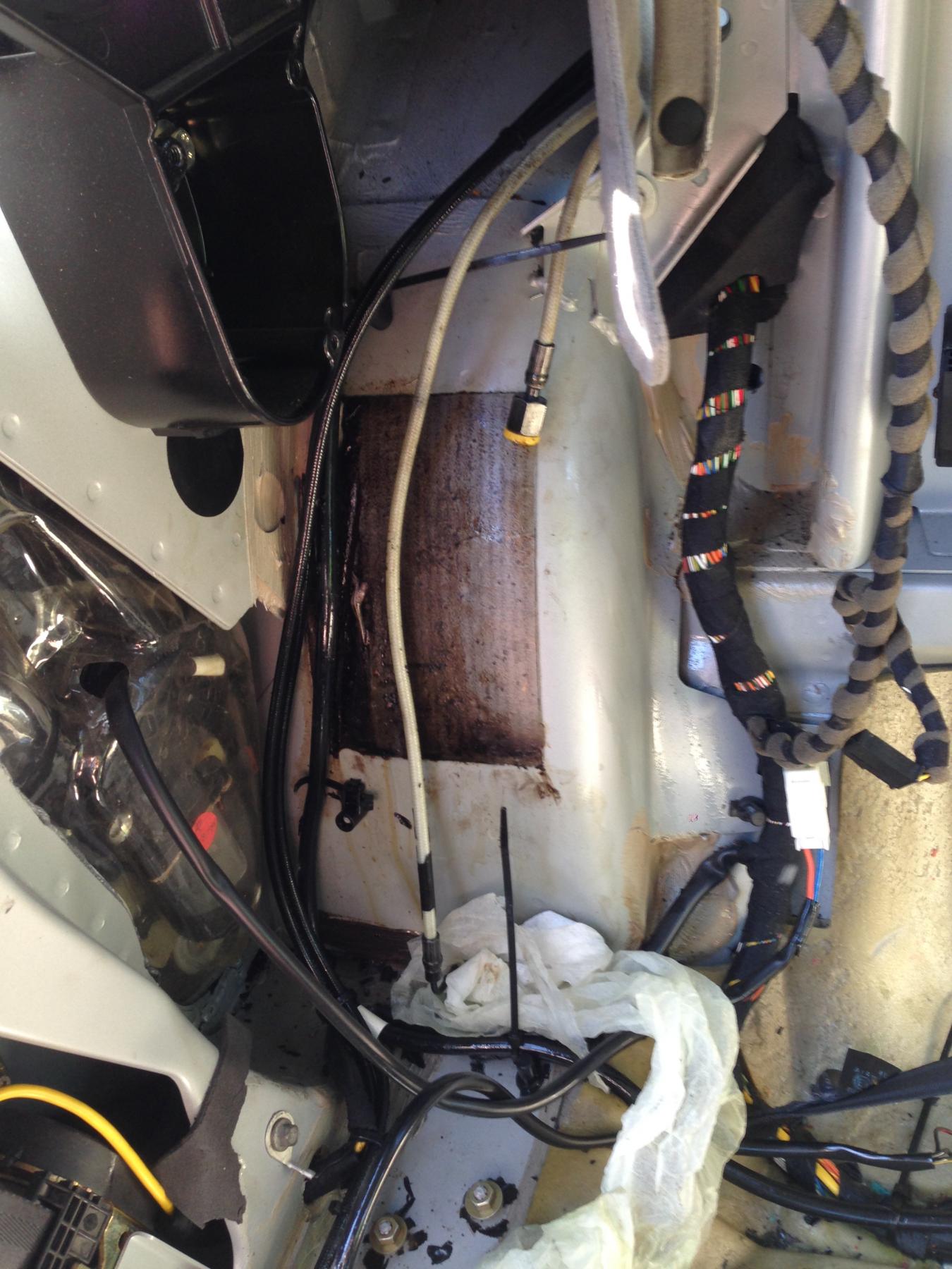

Well, opened it up for a looksee. The rear seats, side & top trim, cross brace and speaker cabinet had to be removed to get at the ram. Not hard, but many layers. (And found that the guy who previously replaced the latch hoses broke the speaker bottom bracket when he did the job. Annoying, but hard to prove. Tip: remove the brace before trying to remove the speaker)
Wet all over from hydraulic fluid. Seeping rather than leaking, so no obvious failure point, but the old hose appears to be disintegrating - the outer skin of the hose is just flaking off all over the place. The hose is wet also a bit above the ram, so it seems a fair bet that it is the actual hose itself that is breaking up and leaking through. A bit odd, as I have not seen any references on the forum to such leaking. Also strange that it wouldn't be a more major leak if it is the hose that is the culprit. The connections at the pump are fine; no problem there.
However, the hose needs replacement anyway, so I will start with that and see if the leak goes away.

Status update: I took the interior apart [they did an excellent job hiding the hoses and rams behind just about anything inside the car - now it feels like I have more Jaguar in my workshop than in my Jaguar..] and found that the hoses are indeed shot, but so are the seals in the rams. I also realized after a more thorough search on the forum that the rams and ram hoses are more problem prone than I first thought. So, wrong heading on that first post..
Got the upgraded hoses from Top Hydraulics before I realized that I needed the rams as well. Top Hydraulics refurb rams, but two times cross-Atlantic shipping didn't sound tempting, so called SNG Barratt for the rams.
I am VERY impressed by SNG Barratt!!! I ordered the rams on Wednesday, they got them from Jaguar on Thursday and then shipped by UPS to me. Arrived in Norway today Friday, just two days after I called them. Price much less frightening than I had feared, and they shipped the right parts (I was holding my breath on this, as the ram fittings were changed halfway through 2000). Good going!
Now I finally have all the pieces and am looking forward to putting them back together in the weekend.
A bit annoying that the latch hoses were replaced by PO some months ago, using OEM hoses. Guess that will be my ongoing worry when operating the top, but it just seems a bit daft to replace fresh hoses. Does anybody know if the seals in the latch cylinder are prone to leak like the main rams? Should I consider replacing that as well now that I am at it?..
At least I am getting to know the car!
