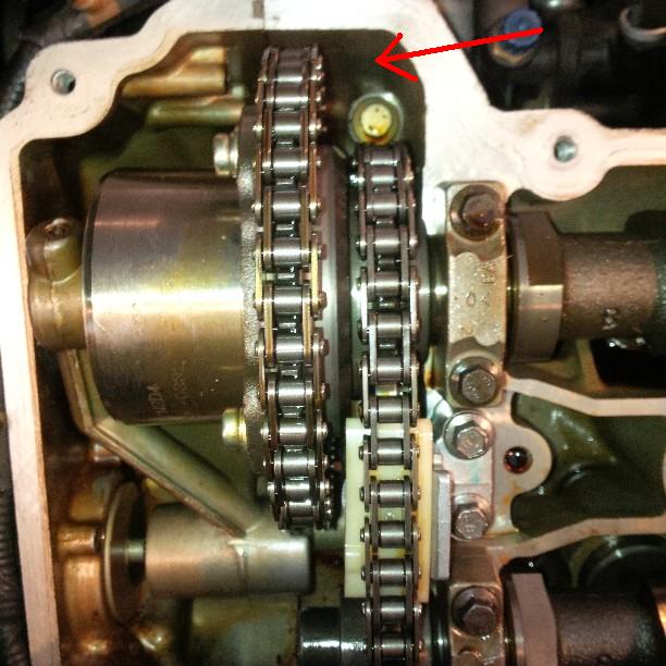

I finally got to finishing up the cam chain adjuster upgrade but I've run into a bit of a problem. while taking off the left side cam cover the gasket stuck for a moment and when I pulled it off 3 of the bolts popped out. 2 of them I found right away on the garage floor but the last one is gone. I searched for a couple of hours even putting the Jag up on stands and feeling around anywhere I could get my hands but no luck. My fear is the bold dropped in to the cam chain area. I'm not sure what to do next, should I drop the oil pan? I'm afraid to proceed thinking that the bold would work itself into the cam chain and destroy the motor. There are 1000 places the bolt could have lodged itself I'm just thinking worst case. Ideas?

Solved! I dropped the oil pan and found nothing. well that's good. Got about 1/2 quart of oil in my ear. Then I pulled off everything that comes off in the engine bay. All the while poking around with the magnet on a stick. Then to my surprise I heard a faint clink. Somehow the bolt got under the intake manifold down in the valley. Not where I suspected it would go but I found it!! yeah, now I can put the whole darn thing back together. I think I will have a beer and do it next Saturday.
