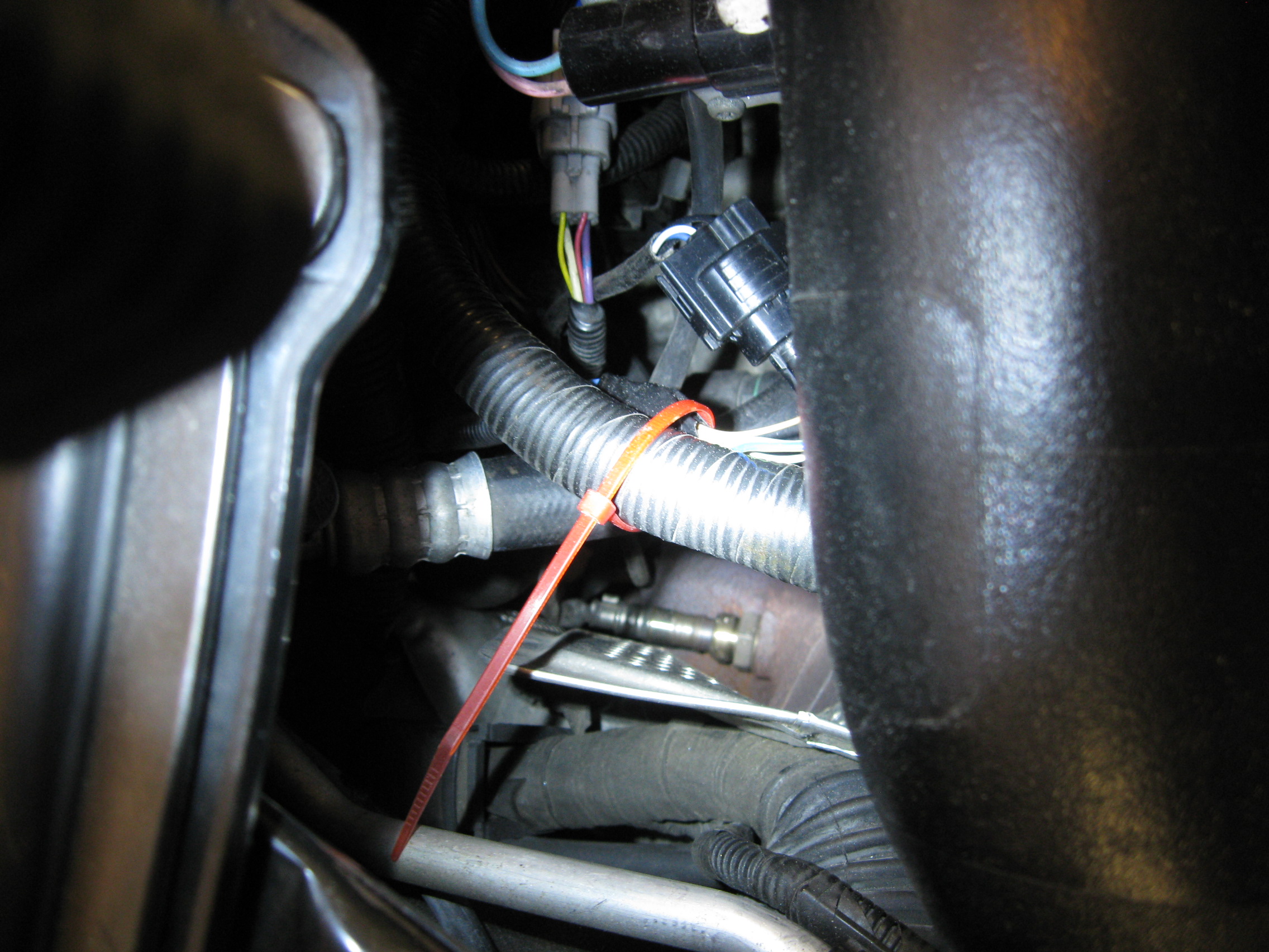

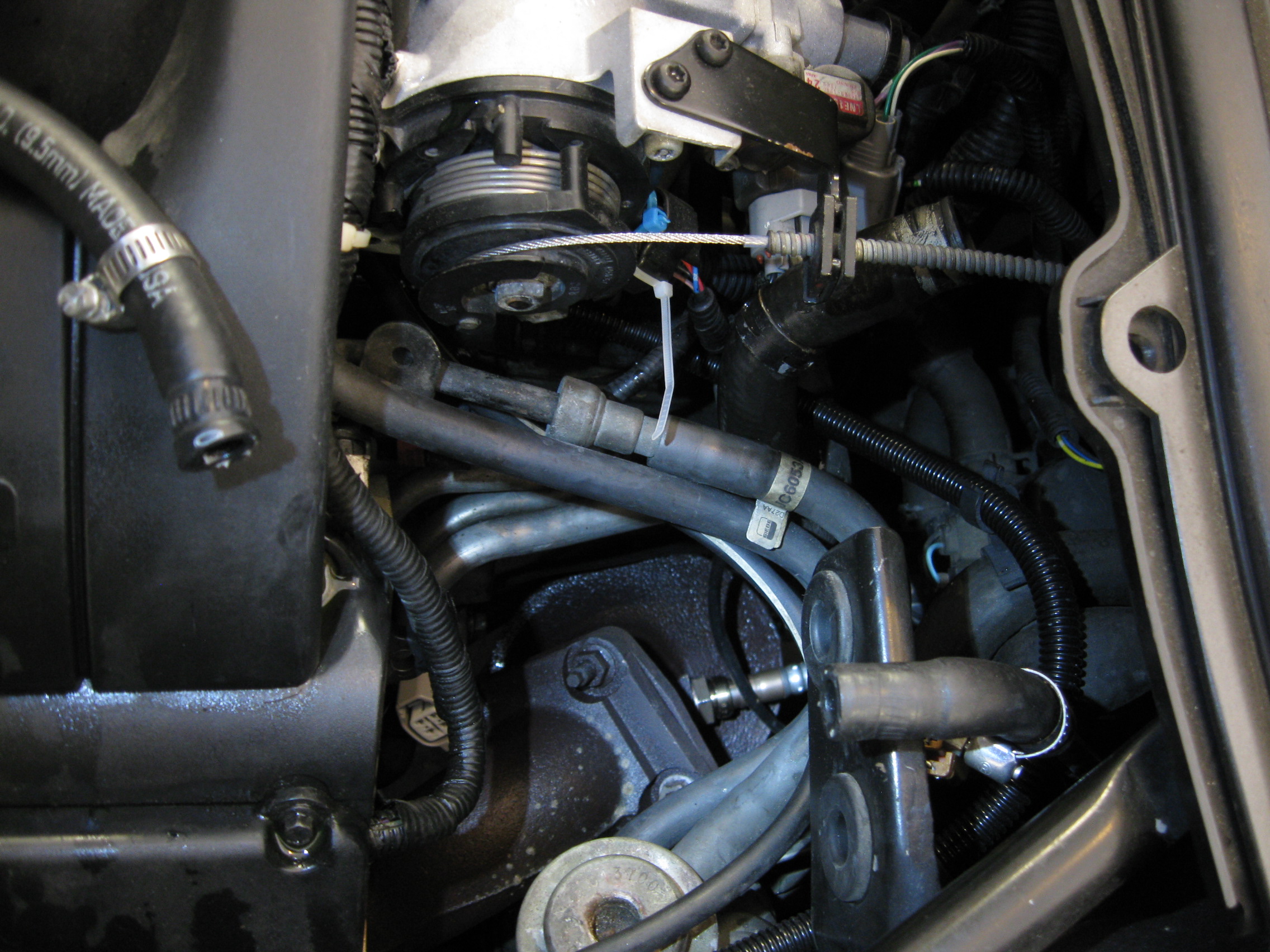

Now for the O2’s I replaced all 4 of my sensors and two top ones I accessed from the top and two on the bottom from the bottom.
Attached Thumbnails O2 sensors & brake switch replacement problems-img_2153.jpg   O2 sensors & brake switch replacement problems-img_2163.jpg
