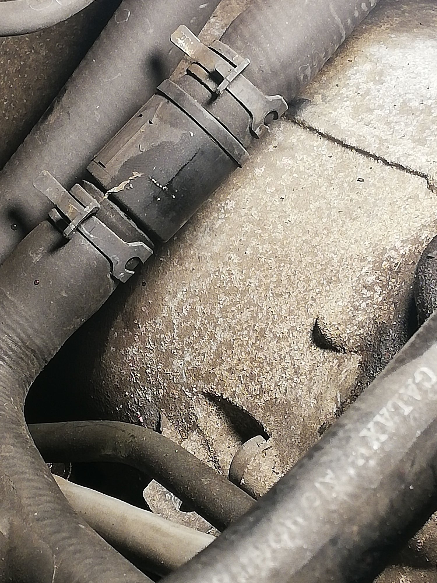

Octopus on mine is still in good shape, just a crack in non return valve (wonder how)

Today I dug up the octopus hose and replaced the cracked non return valve. The valve is deep down but with TB off the car and metal bracket with the many electrical connectors out of the way, it is better accessible than I expected.
Did not even drain the system😱.
lost less then 1 litre. (worked quickly, valve out-in)
Norma connections were okay, I did not touch them and leave them as is.
Will put all back together tomorrow.

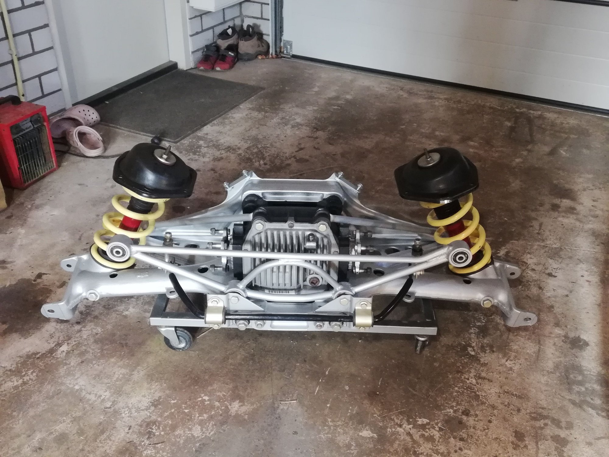

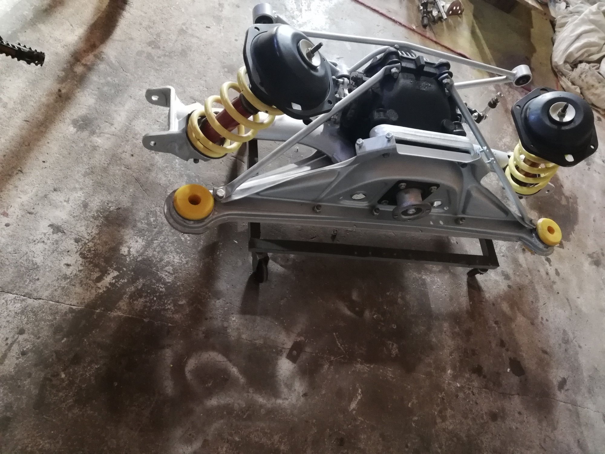

In my case I undertake LOTS of work in the engine bay area, hence many specific tasks get a lot easier thanks to lots of stuff already out of the way. Started with removal of the supercharger to change its pulley to a smaller one. That was one year ago.. one thing led to another.
With the supercharger off I decided to have all bearings and seals inside it replaced. That is done now, only refitting of the SC is pending
There will be a EGR delete. In the slot in the intake elbow where the EGR normally expells its yucky stuff I will instead inject water/meth. Piping is now routed from the trunk but the pump will be purchased later, probably next winter.
I replace almost almost every coolant/heating hose, but unfortunately some of them are still missing at Sng Barratt, waited two months for delivery now.
Both belts will be replaced, serpentine belt replaced yesterday
Probably forgot some stuff I replaced already. The car has been on jackstands for 16 months now
EDIT: Yes forgot some work that I have done during the time the car has been on jackstands:
-Thermostat replaced
-Nav unit delete. Working on a own solution based on a raspberry pi single board computer
-Cd changer delete
-Fitted a temperature sensor to the differential. Will be read from the raspberry pi
-lots of wiring work from the ECU and TCU connectors to read values into the raspberry pi
-Fitted usb port in the arm rest storage compartment
But it all started with a total refurbishment of the rear suspension and subframe, and fitment of a LSD. That project is almost finished now, only hubs and brakes left to fit. But thats another story..
