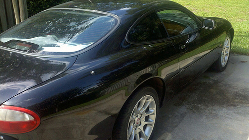

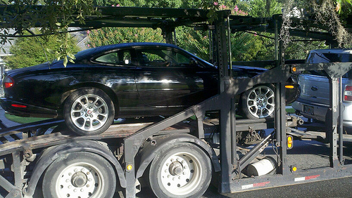

Ok guys here are some pictures. Fresh of the transporter.
Attached Thumbnails Oh god, what have I done?-9507370094_ffeb6ed2b0_d.jpg   Oh god, what have I done?-9507371244_37577d14a3_d.jpg   Oh god, what have I done?-9504578535_39ff5ba97a_d.jpg   Oh god, what have I done?-9504576935_bf88f8881c_d.jpg

Pull the air intake pipe and check the accordion for cracks.. Oh and NICE car!!!!
