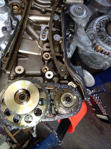

Chains and tensioners came off, first the primary by loosening the tensioner bolts, it poped out. Easy. Noticed the two sprockets on the crankshaft and the lining dots. Something to keep in mind during reassembly.
Proceeded to loosen the secondary tensioner bolts, tensioner remains in place. Chain does not come off sprockets.
Slowly loosened cam cap bolts working in increments from the center out on both cams.
gently wiggled both cams loose while still being held by the caps. Removed the caps from the upper cam, lifted the cam and worked gently out from the chain. Chain remained attached to lower cam sprocket. Set cam aside.
Removed cam caps from lower cam. Lifted cam, set aside, removed chain.

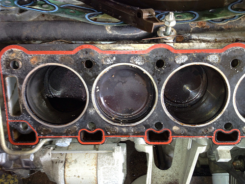

Now on to the head. No major problems here. All bolts came off with more or less resistance but no stripped bolts.
First head is off.

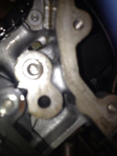

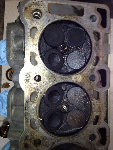

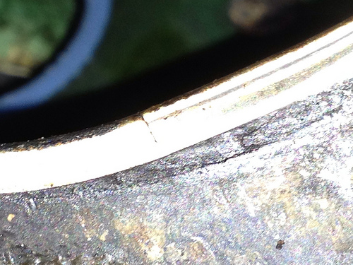

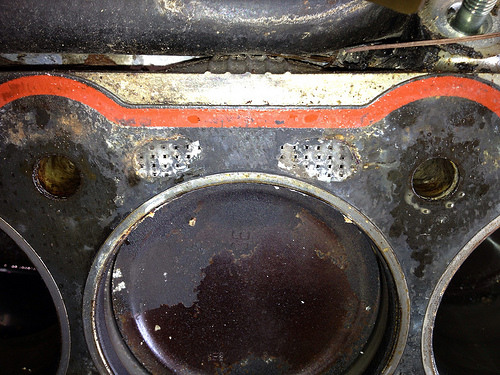

Fount one valve open and the seat loose on the cylinder closest to passanger side.
The head gasket did show evidence albeight light of crack on the second cylinder from passanger side. There are some pinsize holes in between the two center cylinders. Dont know if this is normal.
Is this the original head gasket? What does one look like?

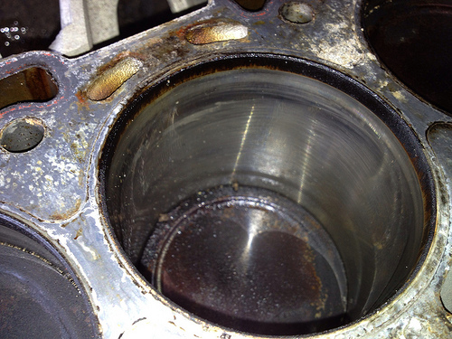

No obvious strike marks on Pistons. No obvious scratches or pitting on cylinder walls. Will clean and report back.

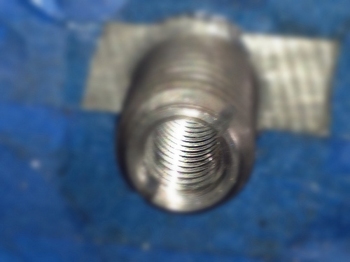

So installed the heads and tightened down the bolts. When on the last bolt I noticed what looked like antiseize on a couple of threads. On closer inspection it turned out to be two spirals of the threads in the hole.
Then tried to torque down to specs and the bolt would just spin. When I removed it this is what I found.
Stripped thread. Oh, God here we go again.
After looking at the different alternatives I chose to go with a system that comes in a kit and allows you to drill the hole to get rid of the old threads, using a jig to make sure you are centered. Then you cut new threads of a larger size than was there and insert with locktite a steel insert that has the original thread on the inside and the new thread size outside.
I will be posting a how to on a new thread.
Here is a picture of the insert.
Drilled and studded all ten holes on that side. Reinstalled the heads and proceded to put the engine and car back together. Serviced the transmission, replaced all hoses, changed knock sensors and camshaft sensor on drivers side.

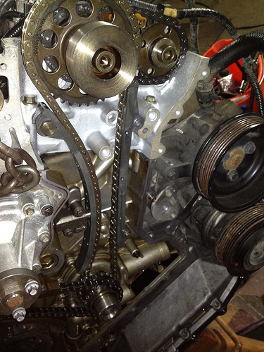

It turns our that the Xk8/Xj8 have an oil passage drilled open for the VVT. Our XKR's have a plug in the passage. There is a TSb on the matter.
You can clearly see it here under the exhaust cam sprocket.
and on the othe head.

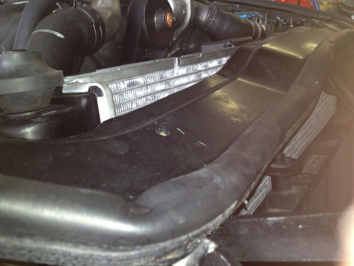

JT I agree that the ideal situation and my goal is to return the vehicle to original Specs.
I have been however, dealing with a rather unique circumstance. If you read my early postings on this thread, you will notice my suspicion that this car had sometype of incident with the right front end.

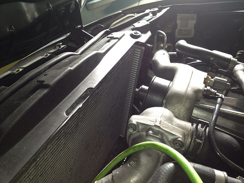

After much searching I found a fist size indentation under the radiator support. This caused the radiator to be 1 1/2 inches higher than it should on the passenger side and 1/2 inch higher on the driver's side.
It must have run over a curb or parking block or a solid object. That is some tough steel.
This is probably what is causing the air not to bleed out. Thus my search for solutions and finding the thermostat modification I tried to apply.
Yesterday the radiator support was fixed and now they settle nicely in the engine bay.
I purchased another (4th) Thermostat, and proceeded to fill with coolant and bleed the system. Here is how it is installed.
Started the car and to my dismay it still runs hot.
Let her cool down, partially opened the coolant reservoir cap to let pressure escape. You can hear the gurgling as liquid flows to the atmospheric recovery tank. Bled more air out and added more fluid. Retightened the cap, took off the plug at the supercharge cooler, bleed some more air, added more fluid. Used the supercharger pump to move things around. I have squeezed those hoses to the point I could probably milk a cow by hand.
Restarted the car and.......... She is still running hot.
Car is at the painter's getting some touchups. I have until monday to rest and regroup.
I've run down the battery a couple of times. I do not know if from the drain of the pump or the fans and heater blower beeing on. But it makes me think.
Could the belt be loose and not turning the pump and the alternator properly? 13.8 Volts at the battery with everything turned on the car. Belt is installed correctly, new.
Could the belt tensioner not be working?
Could the new pump be bad?
Is the new thermostat not opening??
I will gladly accept any suggestions as to what to try next.
Reinstall my moded thermostat?
Run for a while without thermostat ?

Well guys, Success at last.
Operating temperatures in the 190-208 range. Drove her home from the shop 30 miles with no incident. Took her to a carwash to get her all nice and shiny after 3 months in the shop.
Here she is in her finest.
It feels great. Thank you all for your help. Not a bad Xmas present.
Merry Xmas to all.
