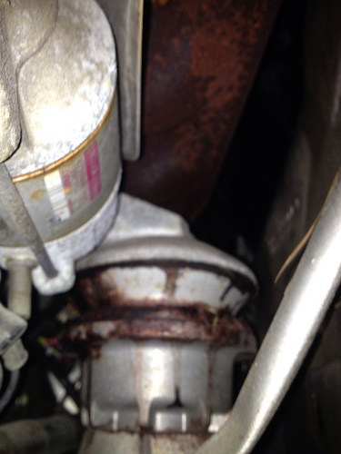

Dsnyder, I have not taken the ABS module off the pump.
I will if nothing else solves the issue. I have read the two procedures for accesing the solder joints. Lets hope I dont have to go there. The lines and tie downs look undisturbed, so I think no one has been there. I will let you know what I find.
On another thought I did find a rather sorry looking engine mount,I've never dealt with this kind (hydraulic?) here is a picture. Also one that looks brand new down to the nut holding it from the bottom. Is this roached? Difficult to change out?

Glad to hear the fans are working. Yeah, if the a/c system is not charged the compressor will not activate and the fans will not click on until coolant temperature rises (no pressure signal from the high side switch to activate fans).
Wow... I'm fairly sure that mount is hosed!
Should look like this:

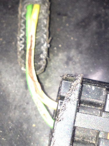

We continue to make good progress.
After the coolant and oil flush (new oil 15-40(dino) + Marvel oil) and refitting the belts, (what a Pain in@#, had to remove the right side radiator hose in order to move the tensioner for reinstallation of the supercharer belt).
Restarted the car and added freon to the A/C.
Compressor started and so did the right fan. We think there is a leak in the system. Will add some UV dye and leave that repair for later.
Checked the ABS connector pins. Made a rookie mistake by not taking a hardcopy of Gus' ABS Hard Fult Check list. I took ony the pin # info and missread the numbering. Printed a copy and now will recheck.
Loosened the connectors in engine bay over wheelwell and took a reading. Both front looms and sensors within spec. I did find that the wiring on the right hand side had been peeled exposing the wires. Fixed with electician tape.
ABS light still on but I now have a code C1165. Looks like the problem is on the rear right loom or sensor. I had suspected this, as the sensor I removed with some force from the front drivers side is now installed there.
I will recheck and replace as needed. Also check the rear loom boots.
I understand the rear looms ends below the rear seats?
I am also now able to turn off the Engine CEL.
The car runs for several cycles with no codes. On restart I comes back.
That mount is toast. My drivers side mount was looking like that, and it came out in two parts. The mount had completely separated!
To replace, engine has to be lifted up a bit, with the air duct removed. Drivers side is worse, since you have to drop the steering gear as well. My mechanic charged me 2 hours for the pair.

If the CEL is flashing, the ECM thinks there is a continuous misfire, and will go int restricted performance. If its misfiring, you'll know it, the engine sounds horrible. If the knock sensor IS bad, iy it could be incapable of helping the ECM to adjust the timing, so check that sensor. Also, in real time, monitor the fuel trims, likely you have some air / vacuum leaks from a long slumber.
C1195 is the code that arises from the ABS internal grounding fault. Its time to pull it and rebuild by a third party, or try it yourself. Keep up the good work, i'm enjoying reading about your progress and the small successes you are achieving.
