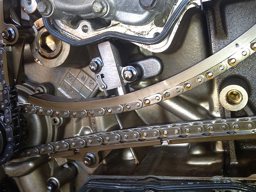

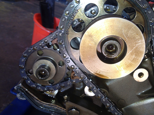

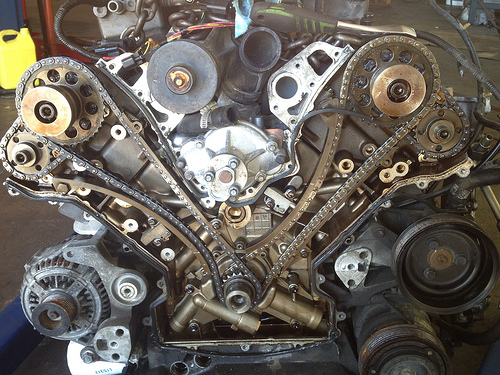

Finally did find the bolts and proceeded to remove the engine yesterday.
It was not as difficult as I imagined.
Removed all of the front pulleys and belts as well as the font cover.
Removed the Cam covers as well.
Now comes the time for panic. Today I will remove the supercharger and intake.
The question now is, how to proceed next. Do I need the special Jaguar tools to remove the camshafts and tensioners?
I am reading JTIS and frankly I am confused.
Will wait for guidance.
The front looks brand new, there are marks on the crankshaft of recent work. I imagine for the chain and tensioner replacement.
From the looks of it it has not jumped time. I want to know if it is safe to rotate in order to line up the flats on the camshafts to make certain.
Attached Thumbnails Oh god, what have I done?-10557543703_b66d4f4555_d.jpg   Oh god, what have I done?-10557255096_b1e4debf26_d.jpg

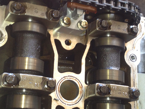

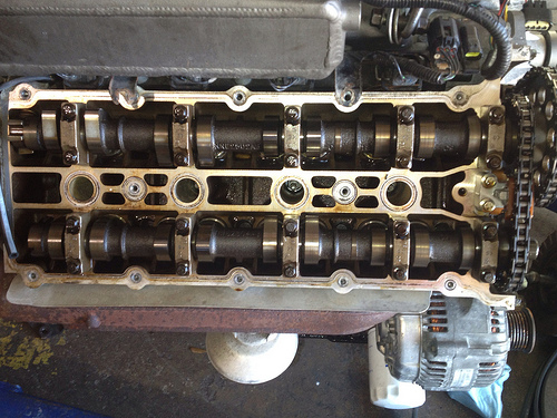

Additional pictures of camshafts and tensioners.
Attached Thumbnails Oh god, what have I done?-10557237765_75582a9035_d.jpg   Oh god, what have I done?-10557367924_626e62d95f_d.jpg   Oh god, what have I done?-10557361014_1fa44b0b4d_d.jpg   Oh god, what have I done?-10557533533_f5568657e9_d.jpg   Oh god, what have I done?-10557267735_0f79f3623f_d.jpg
Oh god, what have I done?-10557285686_f8cce29bca_d.jpg   Oh god, what have I done?-10557512843_4303831dc5_d.jpg   Oh god, what have I done?-10557313434_3e2f6ca767_d.jpg

Don't really see the benefit of turning the engine since you are going to have to remove both heads anyway....
It shouldn't do any harm if you are just rotating by hand- only turn the engine (at any time, ever) in the normal direction of rotation when running.

Do I need to lock the cams while removing the tensioners and chains?
Are all cams the same?
Old Oct 29, 2013 | 12:39 PM
  #94
dsnyder586's Avatar
Joined: Jun 2011
Posts: 2,134
Likes: 542
From: Costa Mesa, CA
I just unbolted the cams and the rest comes apart pretty easy after that- I guess it would be easier if you lined up the cam flats as that is where all of the valves are closed. (not much pressure forcing the cams up)
Make sure to loosen the cam caps slowly and evenly, and try to get the cam loose before unbolting them all the way- this will prevent cams from jumping up and or breaking.

Label the cams as to position.....they've worn into their bearings and would be best going back where they came from. Same goes for the bearing caps. If you're taking the heads off, the current timing does't matter because you'll be setting it when things are back together, so don't worry about the flats at this point. Those pictures, btw, look pretty good as far as the timing gear train goes.

Ok Guys, lets see if I got this correctly.
Rotate engine clockwise until flats are parallel to each other in order to release pressure on cam lobes.
Loosen chains by fiddling with the tensioners. Remove chains from sprockets. Leave sprockets on cams.
Loosen cam caps slowly and evenly.
Wiggle cams while still nesstled on head.
Remove cams.
Mark cams and caps to reinstall in same place.
Remove bolts on cylinder head.
Remove head.
Pray to the gods of Coventry!
Collect one ounce of Glenmorangie.

When the Flats on the front end of the Cams are Parallel, the lobes are NOT at the "No Pressure" point. Some of the Valve Springs will be compressed at this point. The "No Pressure" point is at a different rotational position.

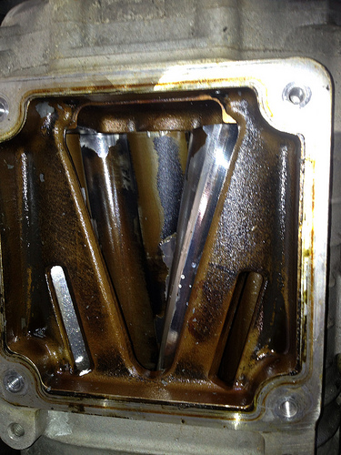

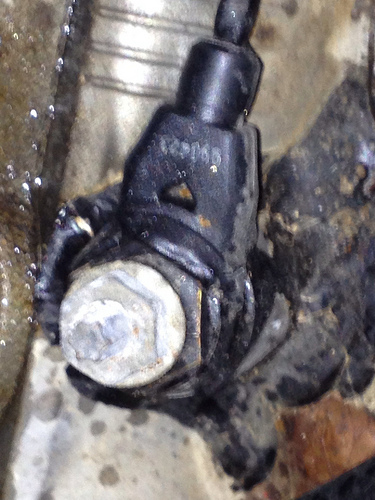

Progess report.
Supercharger and charge coolers came off without a hitch. Noticed the paint in the scrolls on the supercharger are loosing their protective paint. Also a good amount of oil present.
Is this normal?
Found several problems in the valley. Both knock sensors showed severe melting. also one of the camshaft position sensors cam out in pieces.
Hoses look to be in good shape. No leaking. They will be replaced anyway.
On to the chains.
