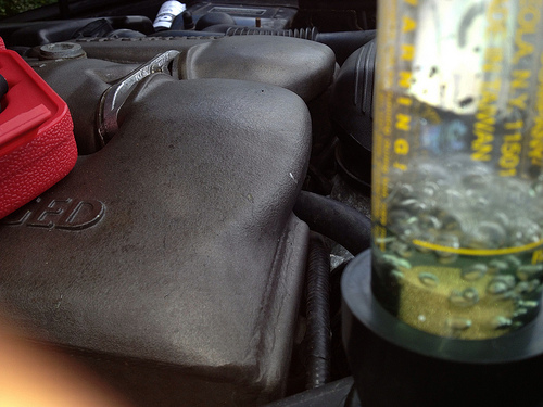

Prior I made a block test. Repeated it twice with no change of color on the liquid. I did get a lot of bubbles comming from the expansion tank. Possible Air lock?
I rapped a couple of times on the T-stat housing. Both hoses are now hot.

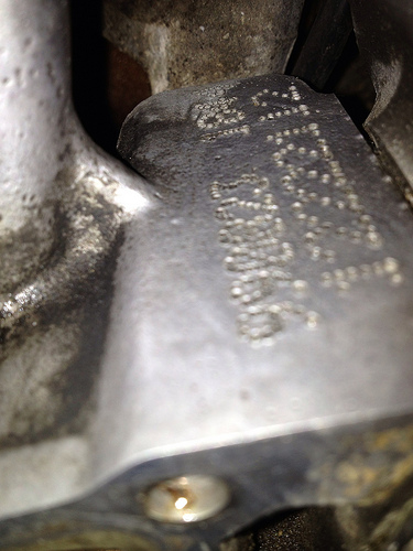

I was asked to look for the engine number. After removing all the gunk around the water pump found this;
990823xxxx
Thank you

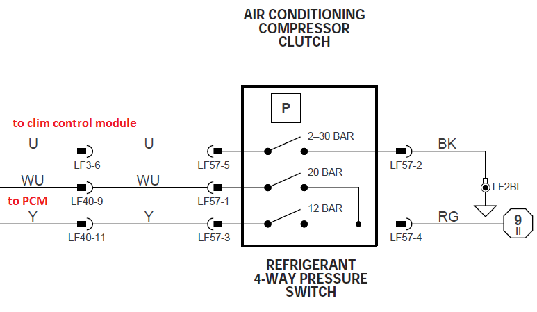

Hopefully that relay will fix it. I'm thinking your a/c is a secondary issue to the fans. Get those working first then check the a/c system charge as you said.
Here's your a/c pressure switch:
It's not a pressure transducer as I though, but rather 3 binary switches. The top switch tells the climate module that there's a/c pressure, the bottom two tell the PCM feedback when the a/c pressure is over 170 PSI, and then when it's over 290 PSI.

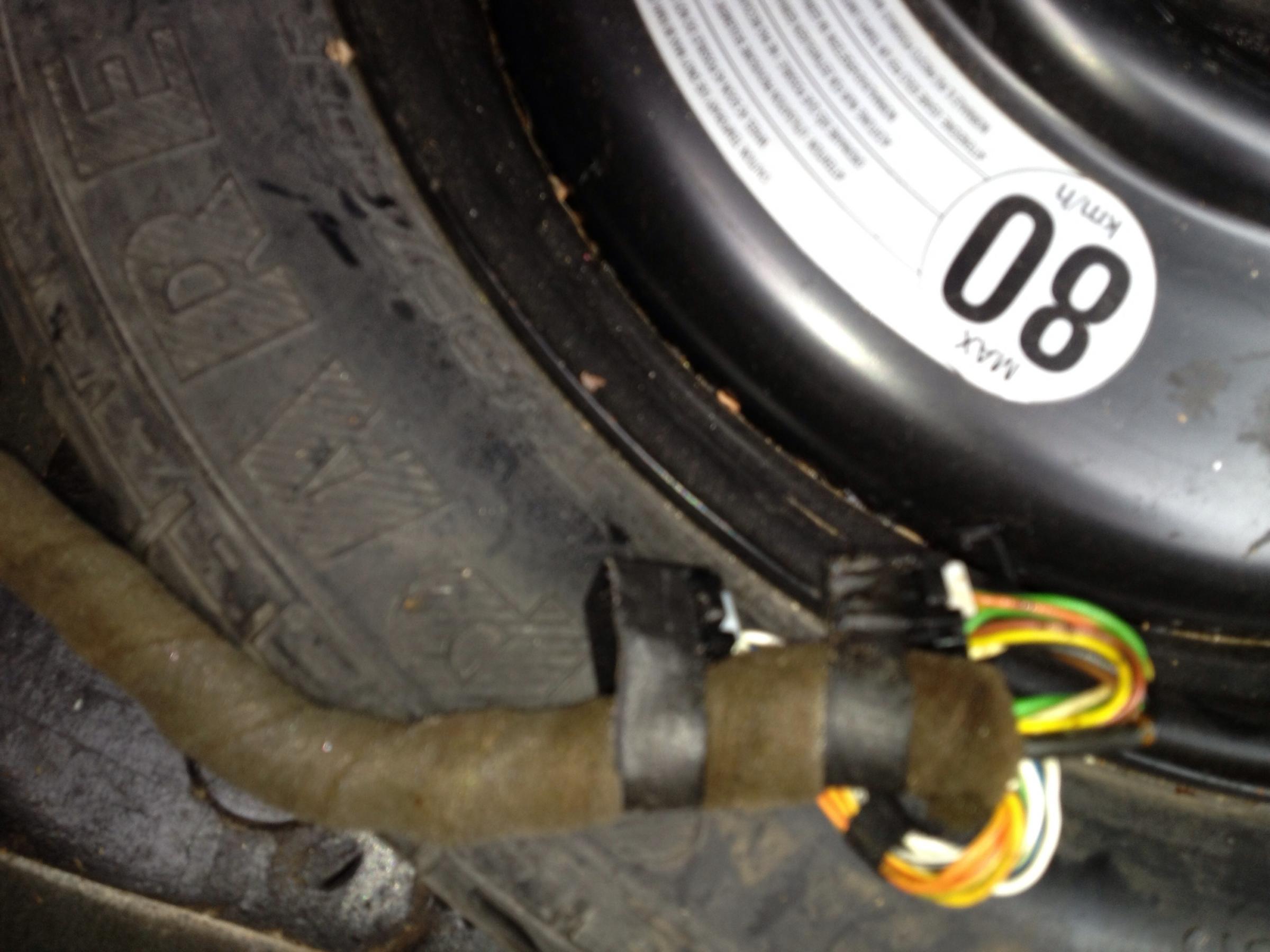

Here is a picture of the wire loom laying in the trunk I referred to in post #46.
What attaches to it?

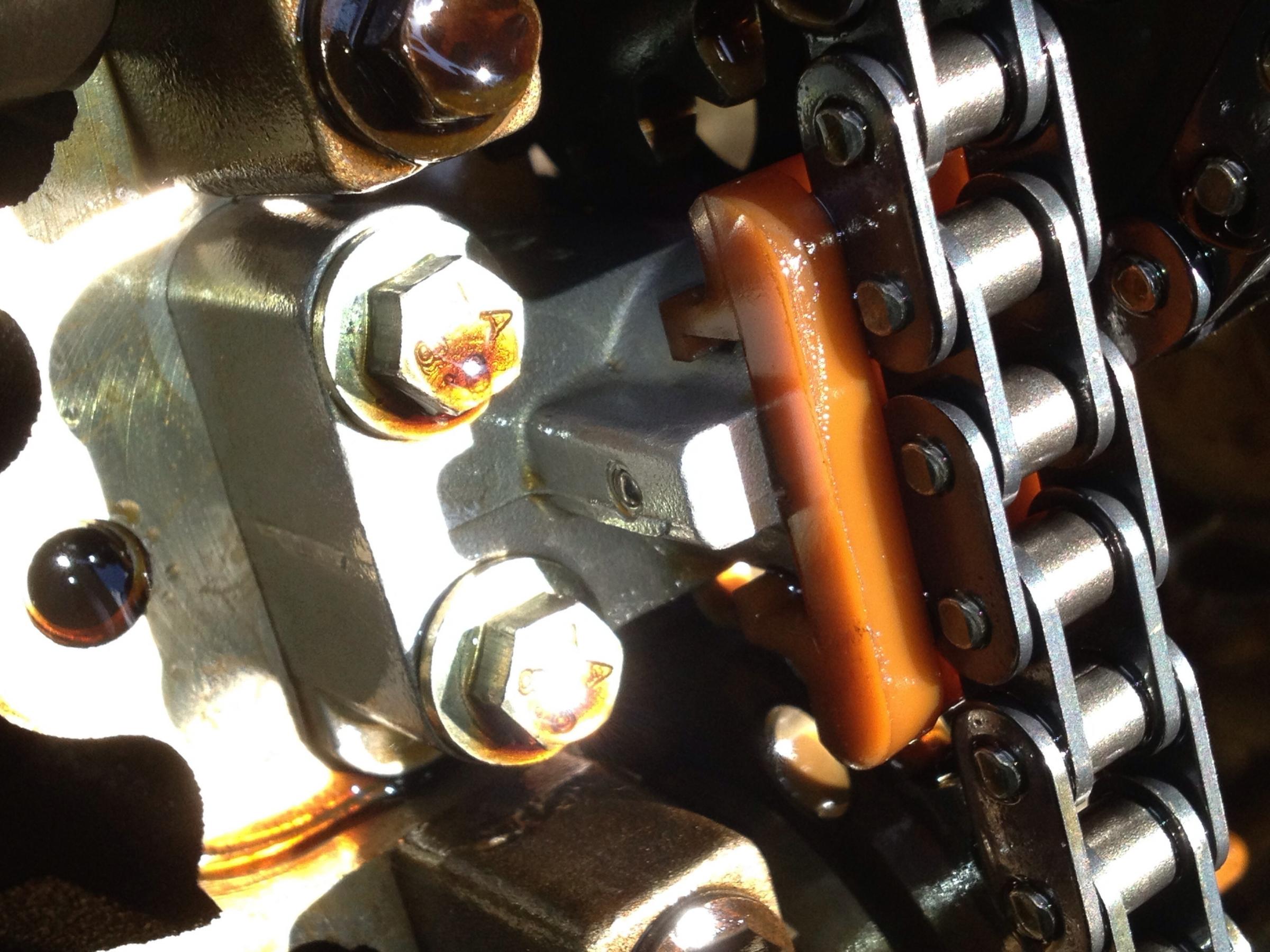

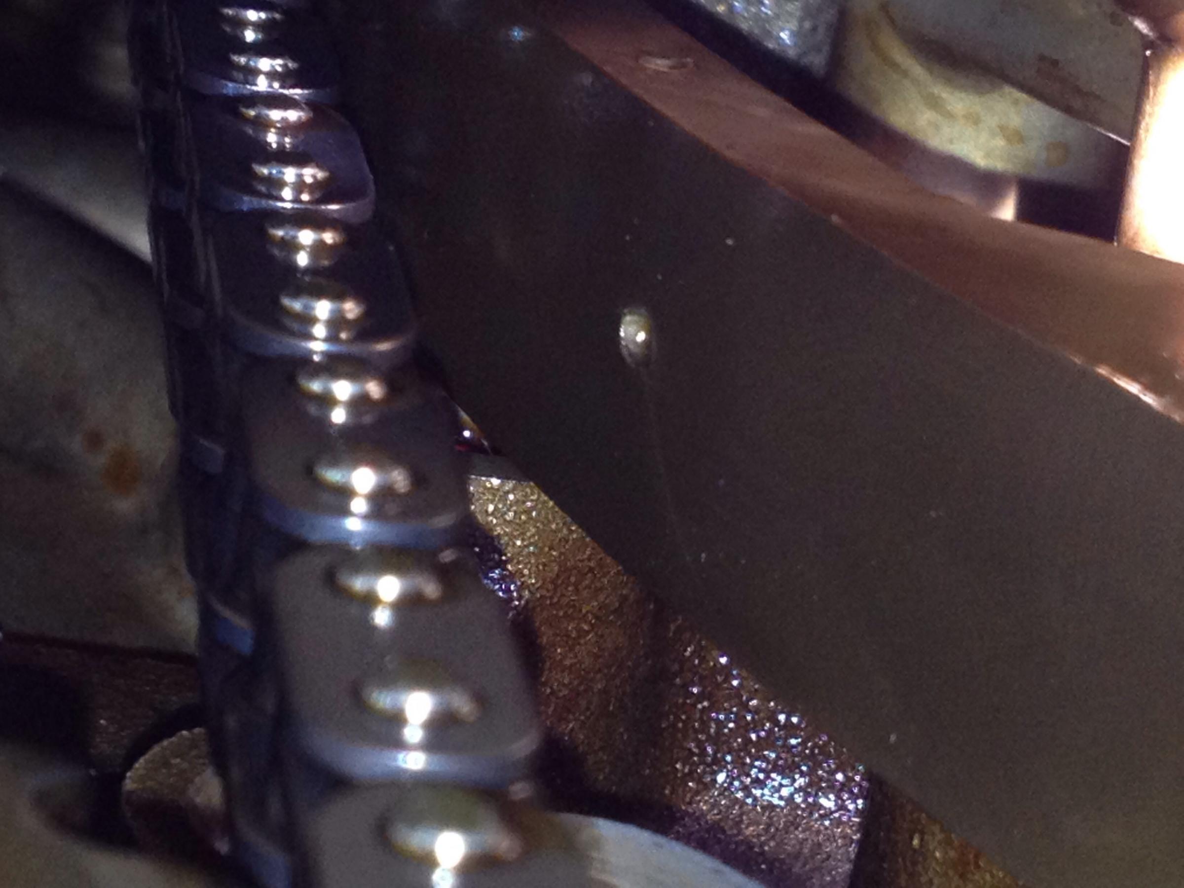

Decided to look under the valve cover on passenger side so as to decide on ordering a chain kit. I was pleasantly surprised by what I found. These look like third gen, correct? No need to replace?
There was a light coating of froth on the cover. Mechanic friend was not concerned by it. He says it is not unusual on a car that has sat to have condensation here. He suggests an oil change and flush with quick change afterwards. Run the car and observe for signs of any head gasket problem.
I'm not so sure.?

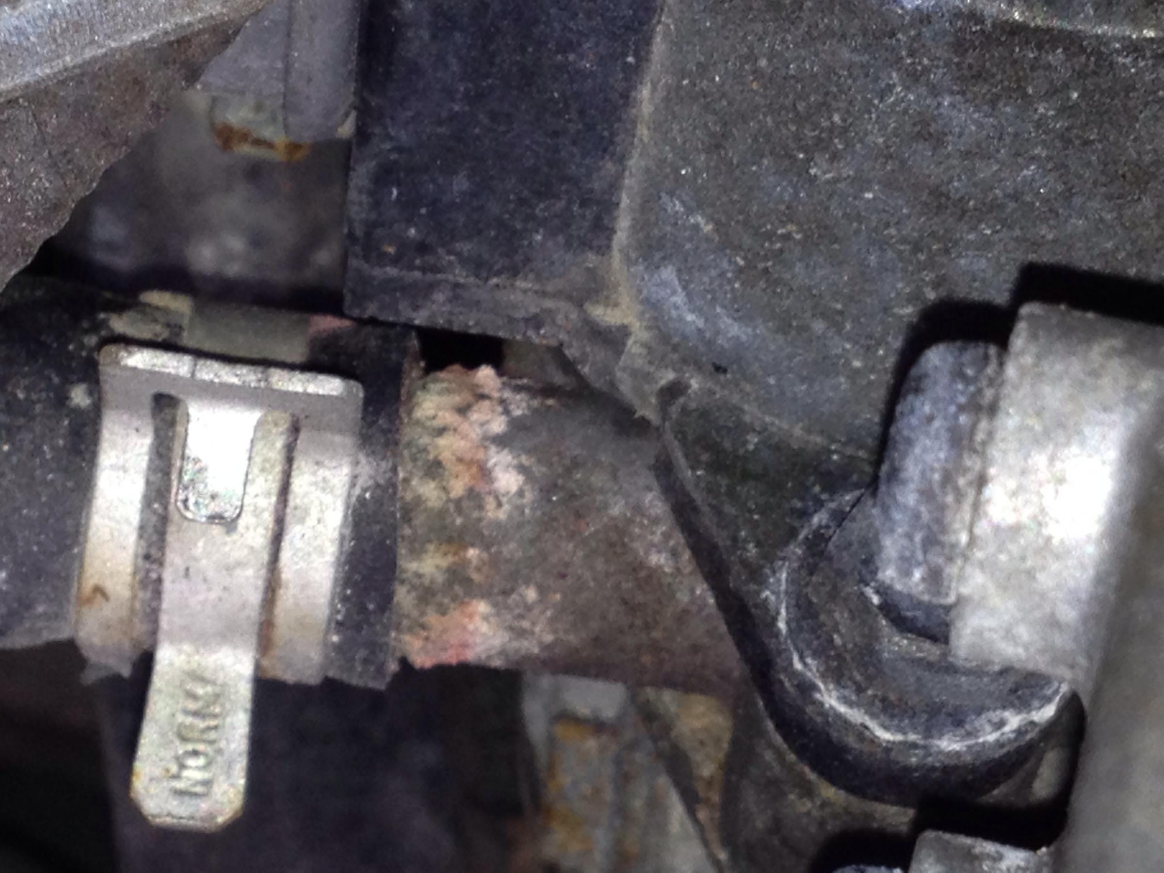

Poking around the rear of the engine I noticed the scales around this pipe hose connection. Could this be the coolant leak I'm looking for?
Position behind and towards the passenger side of Throttlebody.
Attachment 52816
The 2000 MY had an optional cell phone module in the trunk.
