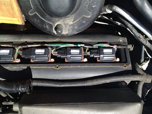

Here is what I found when I pulled the coil covers.
Condition of the coils. Rusted magnets and baked mud on boots.
The plug bore holes were filled with caked mud. Cleaned and blasted with shop air. The last two next to drivers side wee full of antifreeze. My bad I spilled it. So the covers are not water tight?
After some house cleanning.
Sanded clean the contacts for the coils to a shinny copper color.
