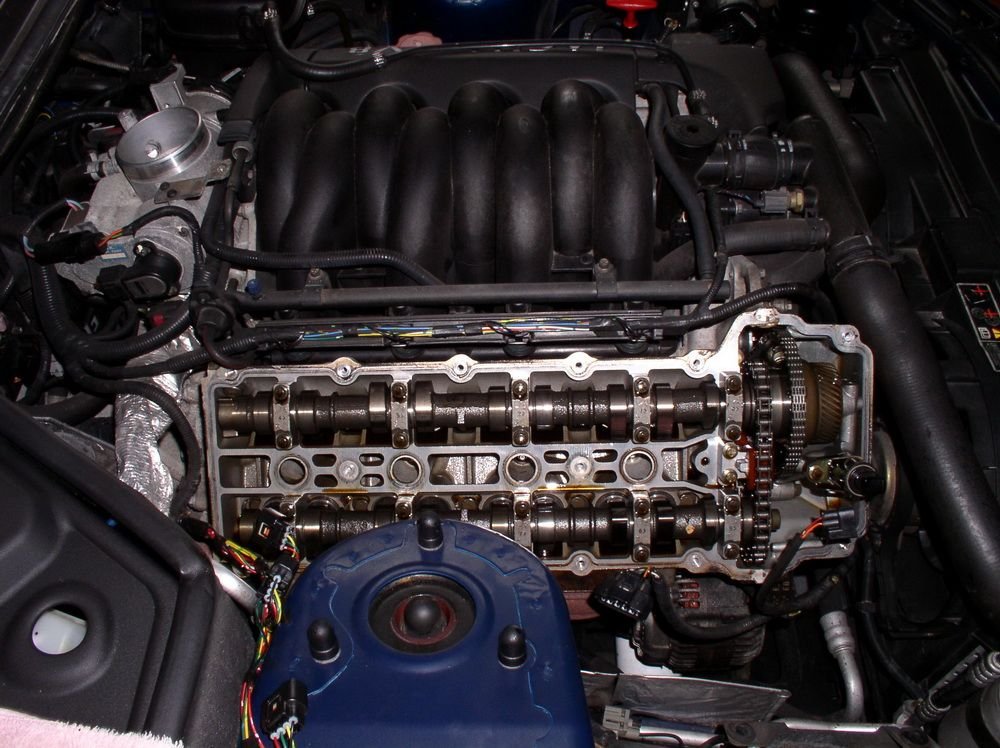

Difficult to describe what looks "normal" but this is my 2001 XK8 at 80K miles. Always serviced on schedule and using synthetic oil:
It's a clean engine and cam cover - typical of most I see.
The arguements against flushing are usually the same ones used against changing from dyno to synthetic oil - it leads to leaking seals. Can't say I've found that to be the case.
