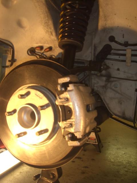

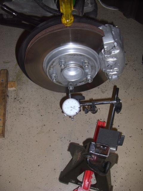

The brake job went smoothly. In addition to swapping OEM pads for the Akibono Ceramic pads, the rotors were checked for thickness and runout.
After removing the rotors and cleaning up the hub face and rotor mounting surfaces, the runout was measured by using a dial indicator. It was within +/- .005" on all four ends.
The left rear banjo fitting leaked a couple of drops, so I tightened them both a little more than the factory spec of 22 ftlbs. Maybe like 25 or 30ftlbs. If they show any further signs of leaking, then I need to source some 10mm crush washers for the fitting bolts.
I included the Akibono application chart for future references. I found the pads on EBay and won the bid at $56. They were listed as fitment for an XJ, but are interchangeable to our non Brembo XK8.
