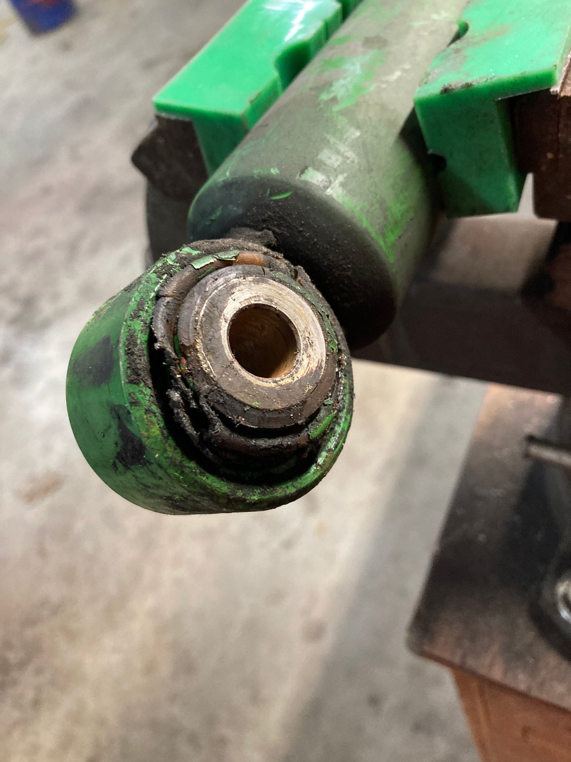

Tackling the front upper strut mount replacement on our 2006 XK8. Inspecting the shocks, I see the rubber boot/seal has degraded but the spherical joint is still good. Anyone have experience replacing these? Less than $100 each from a well-known vendor. Shock prices are.....well, shocking and these seem to work well. I'm seeing a couple options from Jagbits. Input appreciated.

When I did my front suspension, the springs and shocks were good but, like you, the tops were disintegrating and the rubber on the bushings had rotted. The bushings are pretty easy to replace IF you have access to a press. They'll zip right out and the new ones will zip back in.

I did mine with
this kit this kit
and a 30mm socket. Not as convenient as a press obviously, but not hard.

When replacing the lower bushings, did you have to remove the rubber seals before installing the bushing? Actually, my spherical ends are good, it is just the rubber dust/grease seal that have failed.
Yes, but only on the side you're pressing from. I used a small flat screwdriver wrapped with duct tape to pry of the seal rings (two of them). My sphericals didn't have any noticeable slop in them but rotated VERY easily compared to the new ones (and the rubber seals were almost completely gone, meaning gunk was had most likely gotten in there), so installing the replacements was obvious to me.

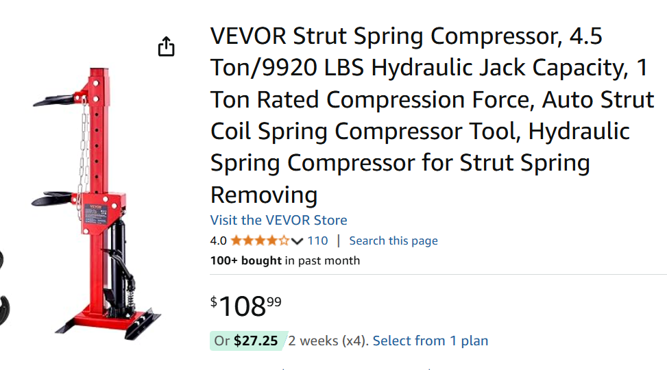

After having a bad experience with my old two-piece spring compressor, I'm going to purchase a better option. I have experience renting stuff from the local parts stores but more times than not, those tools are damaged and/or missing parts. Anyone have experience with this offering from Vevor?
