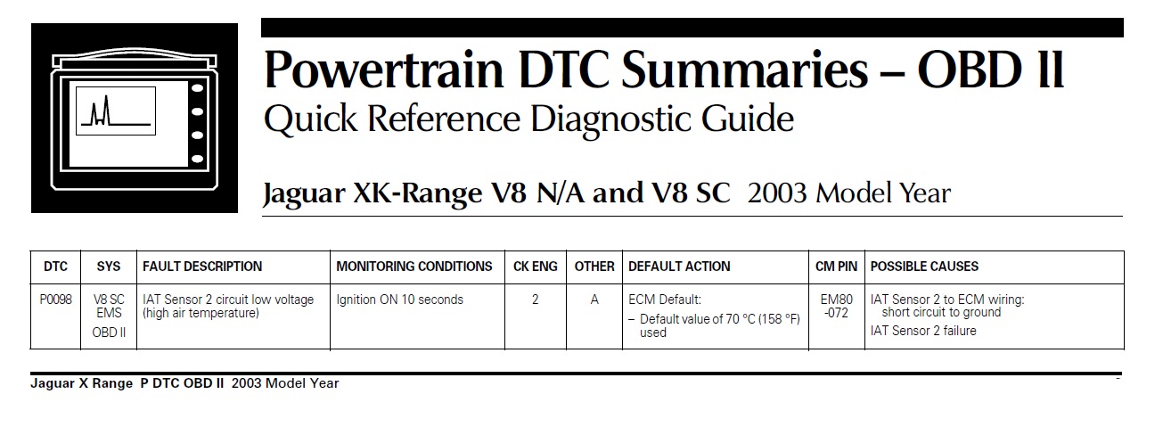

2. locate and download the Jaguar DTC listing for your MY. In it you'll find -
See 'Possible Causes' column on the right.

I'll have to look at the IAT sensor 2. But no idea how to test it.

Unless it's a harness fault, a.f.a.i.k. the temperature sensor itself just fails and has to be replaced. There's no repair or recalibration procedure.
