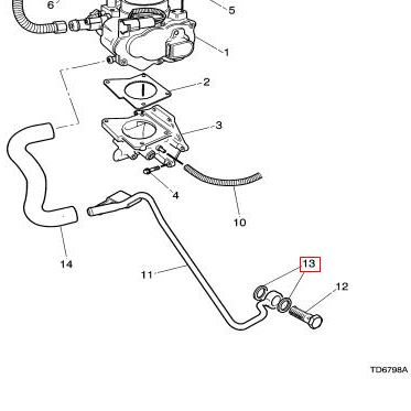

On this XKR, if someone had a problem with loose bolts or relatedproblem with the EGR, would that show easily in a smoke test or might it appear to give a false positive and lead one to think that it was the leak was coming from the duct seal that attaches the air pipe from the air filter/maf?
See attachment- from anywhere in that area and below, would a smoke test be easy to see if that area had a vacuum leak?
Thanks
Tom in Dallas/Plano

The egr is far enough below the throttle body that it should be obvious.
Old Feb 9, 2015 | 07:51 PM
Gus's Avatar
Gus
Joined: Jul 2008
Posts: 11,356
Likes: 2,236
From: Berlin Md.
If you have a leak in the engine bay the smoke test will find it.
