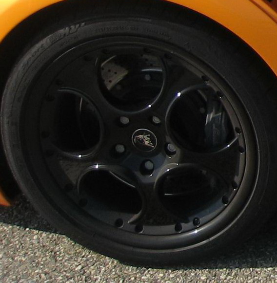

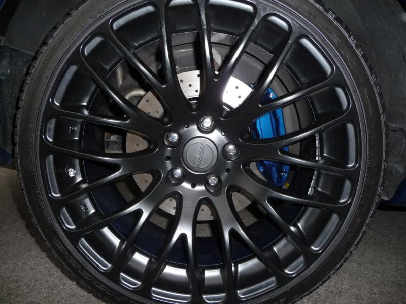

But black on black is nice too

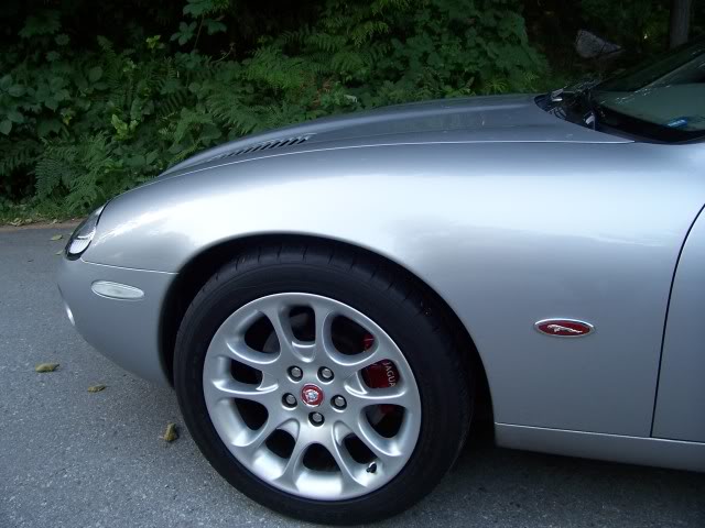

Overall I think for us non-brembo owners the Jag calipers look great painted, especially with that clean retainer spring in place too, a nice clean look without the cost of switching to a brembo system. A few pics of mine just to share..
Fronts:
Rears:
With the stock 18'' double fives on:
(would pop even more with bigger wheels, but I'm happy with my XKR as it is )

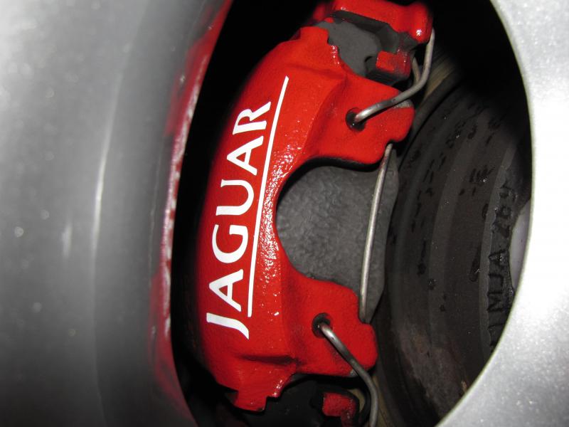

I did the caliper paint last week and it does make the whole car look nicer. I took everything apart and sprayed it. I had custom decals made and then I put a coat of hi-temp clear over everything.

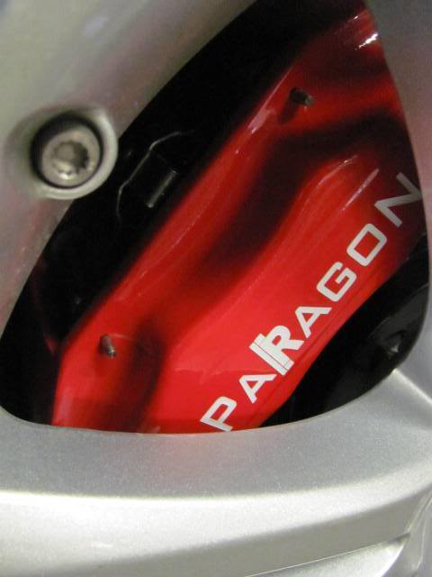

I posted a similar pic on the forum but thought I would get my 2c worth in

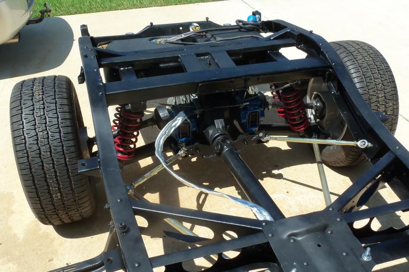

That's a mid 80's XJ-6 IRS. I put it in my 1936 Chevrolet project car. It is a custom "Scimitar GTE" style IRS conversion of my own design. Fabricated bottom plate, torque stays, tie bars, and trailing arms. Look in "my garage" for more info. (Not trying to hijack the thread!) MC
P.S. This is what happens when you take a Jag IRS out of "the cage."

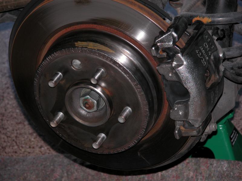

Hey pomosv, didn't catch or see in the post what you used to paint your calipers. Did you use Dupli-color like some of the other guys on here? I'm looking to get my calipers painted since I'm doing a whole new rotors, brake pads, wheel painting/repairing thing. The shop that's gonna do the powder coating on my wheels said they can powder coat the calipers as well. I like the idea of painting the back of the pad the same color so I'd have to hand over the pads as well as the calipers to the shop. I guess they would then back on the color to the pad. Not sure if that's a good idea actually. Gonna look on line for the decal too. Seems like the XKRs have a different caliper than the standard XKs have, eh?

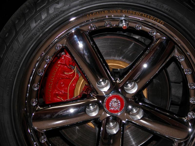

Default My 2001 XKR painted calipers

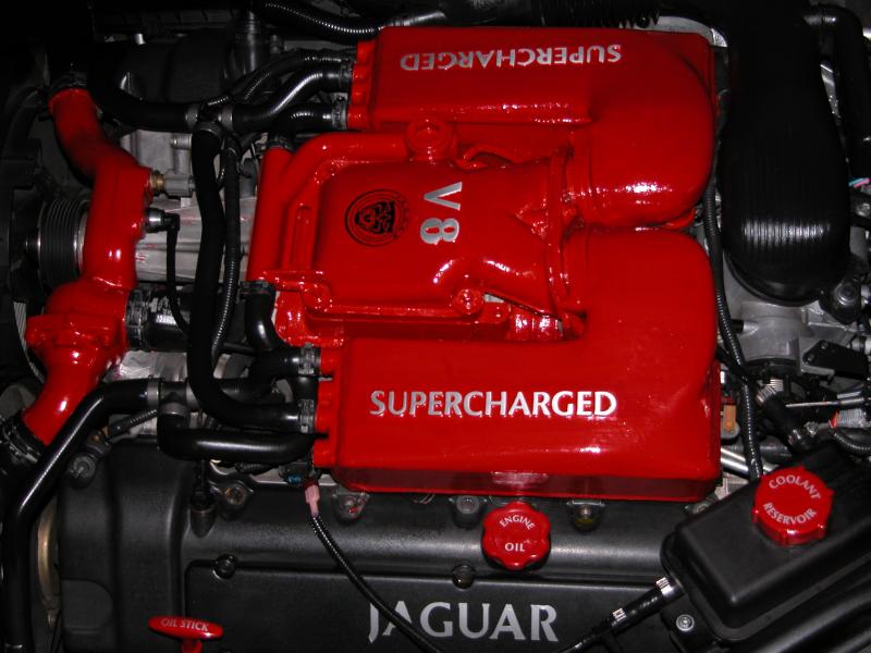

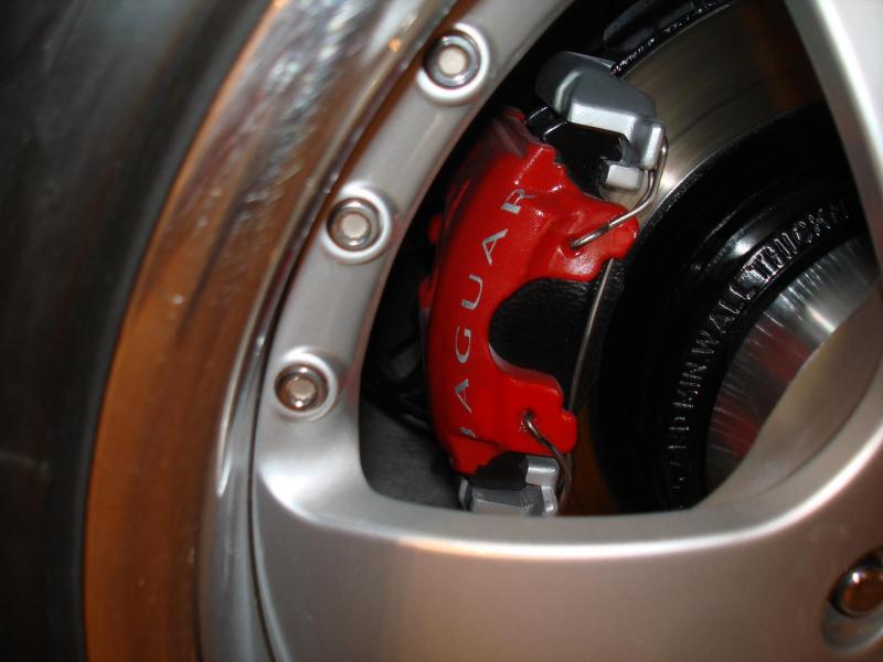

Here you go my 2001 XKR, I did the calipers and the drums.
I chose to do two colors, red for the calipers and gold for the drums.
My car color Roman Bronze has some gold fleck in it so I thought the color combo would go nicely.
Had the local sign shop do my vinyl lettering, just found some artwork on the internet and had them cut it out.
Notice the lettering on the rims as well.
The vinyl is gold color, too.
The job took 2 days , remove wheels , clean calipers using supplied brake cleaner and wire brush drill bit and a lot of elbow grease, paint, let dry between coats (2) and a day of curing the paint apply vinyl lettering and spray clear coat (quality automotive clear coat) over color and vinyl (4 coats).
The job has been done for about six months now and have not had any change in color or any chips.
After I completed the wheels it was so much fun ? and I enjoyed the results so much, I then tackled the engine!
Viola!
Happy New Year and
Happy Motoring...

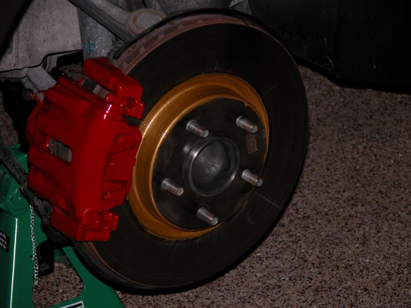

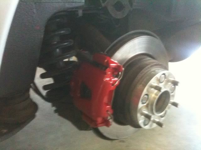

Figured I'd add to the thread. Here are mine color matched. Didn't do decals.
