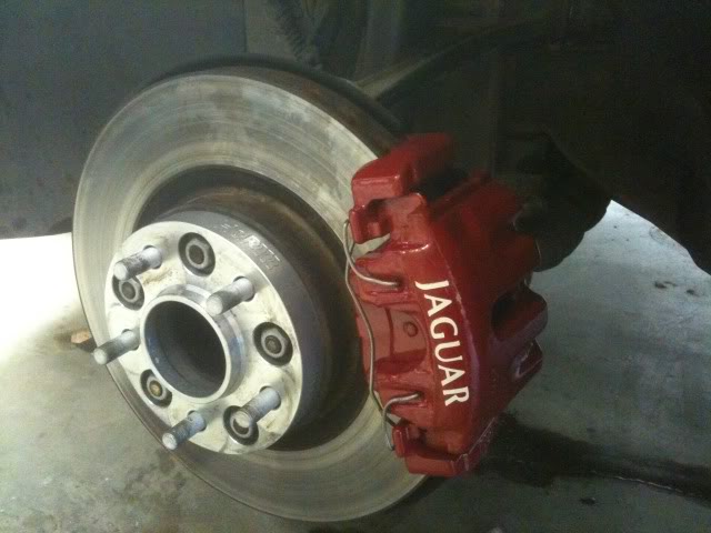

Govatos is right, that's a good tip on painting the back of the pads too (almost then makes it seem like a "full" brembo caliper), but the pads have to be removed for when you paint them otherwise the paint will hold the old pads in place and make a future replacement difficult.
Also, I'd give it a few coats of a high temp clearcoat, makes it last MUCH longer while preserving the shine and making sure the color doesn't fade. This is the 4th car I've painted calipers on and the clear coat makes all the difference for a long lasting finish years down the road.
Lastly, you can get "Jaguar" vinyl lettering, which you can then clearcoat over...nice touch that I personally think looks great, and the decals are cheap, just google for them if you're interested.
Overall I think for us non-brembo owners the Jag calipers look great painted, especially with that clean retainer spring in place too, a nice clean look without the cost of switching to a brembo system. A few pics of mine just to share..

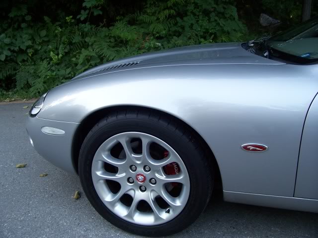

With the stock 18'' double fives on:
(would pop even more with bigger wheels, but I'm happy with my XKR as it is )

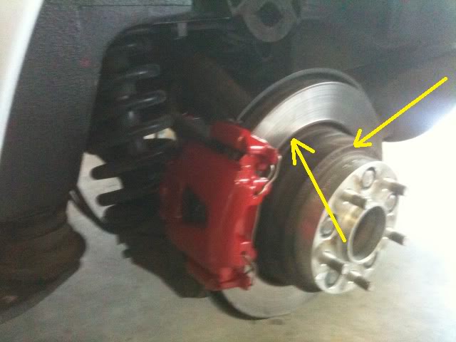

But, if you don't mind I have a question.......Why not paint the hub areas ( as hihlighted in your pic below ? )
When the wheel is attached the hub can be clearly seen and more before you actually see shiny brake disc / rotor.
I've edited your pic to include some arrows that show the area I mean....this looks old, dirty, rusty and tired looking compared to the beautifully painted calipers!

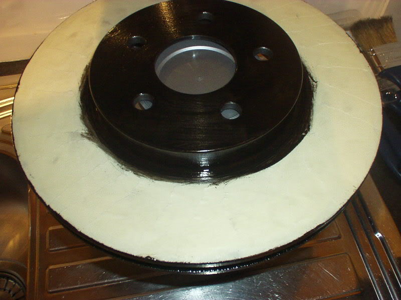

I've attached a few pics further down that show a new hub I was putting onto my vehicle and I had the opportunity to prepare it off the car, which is best obviously.
I've also done this when they've been on the car whilst doing the calipers at the same time.........It gives a much more rounded and finished look, don't you think?
