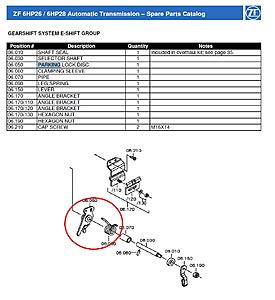

Originally Posted by bcprice36
..... I'm on my 4th XK8-R and have yet to use the Parking Brake.....Mine always has Park on the Shifter Bezel. Personally, I wish Jaguar had not put the darn thing in the Car, as it only gets in the way! .....
Billy,
If there's any hills in Houston you might like to consider just what is holding the weight of the car next time you park on one:
(double click on the image to enlarge it)
If that tiny little lock disc or spring goes then so does your car.
My technique is come to a halt on the foot brake, engage the parking brake and then move the transmission in Park.
The Parking brake is also there as an emergency brake in the event of a hydraulic failure on the braking system. Because it is entirely mechanical it can still operate on the rear brakes to bring the vehicle to a halt. Best checked from time to time rather than wait for an emergency to find it's seized up.
