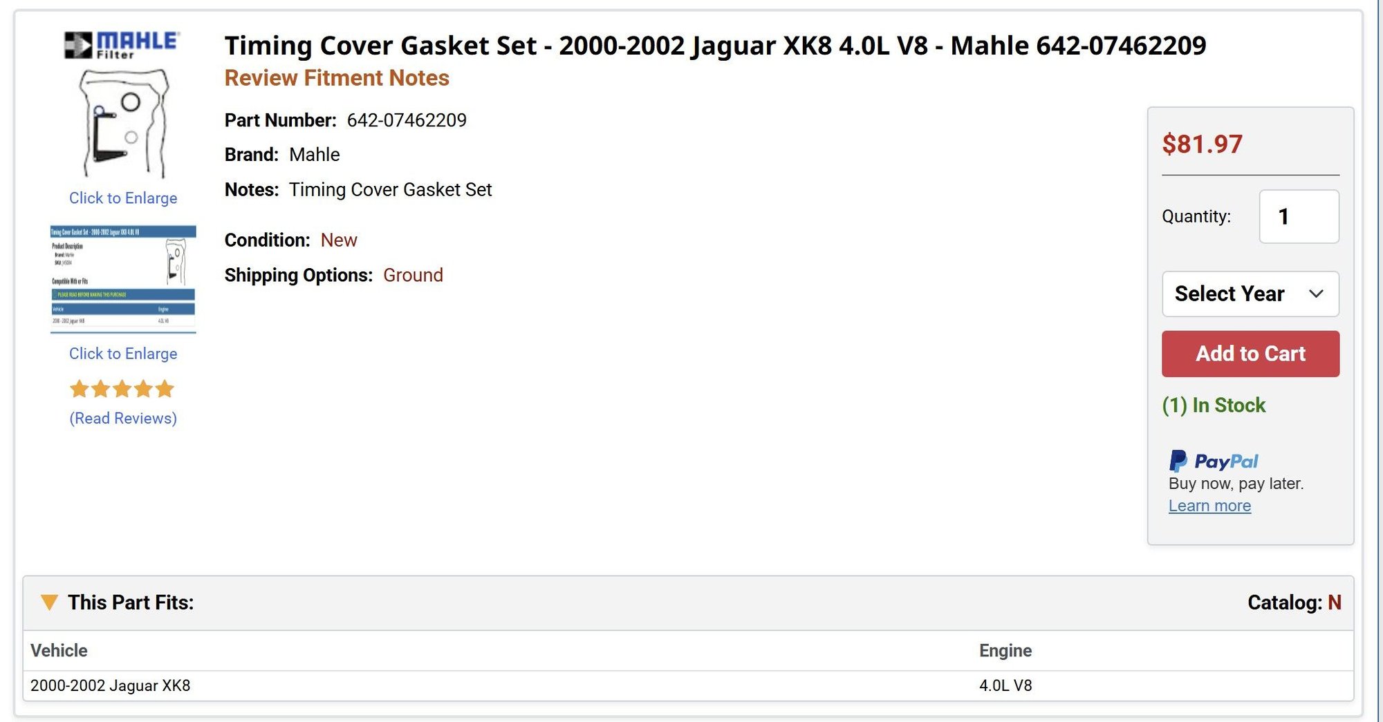

I am getting gaskets for my timing cover, from what i read Mahle is reliable. On a couple of sites it has the dates starting 2000. I am assuming if it is a 4.0, the 1999 and 2000 should be the same, right?

It is the same price for ford and jag, 62 bucks for the MAHLE on RockAuto. I am not doing the cam cover, so it may not be VIN specific for the timing cover. I hope the 1999 and 2000 are the same for the timing cover. All i could find for the 1999 is the Eurospare, which i am not a fan of.

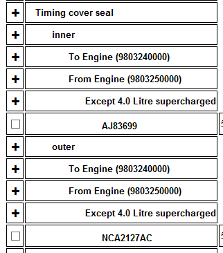

The EPC shows them to be the same through to the 4.2L, apart from a supersession of the inner:
Good luck with the harmonic balancer and don't forget a new crank bolt.

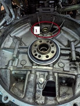

While you're in there, replace the gasket ring on that large hex pipe plug thing at the top, assuming you haven't already.

The oil gallery plugs are known to leak!

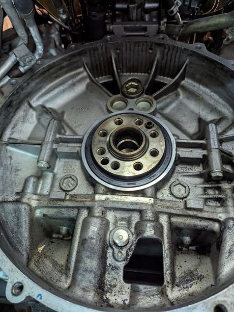

I replaced the crankshaft seal, which is why i took off the transmission.
is #1 the oil gallery plug?

Yes. Jag, in their infinite wisdom, didn't use a crush washer, but a washer with a rubber seal in the inner portion. The rubber gets hard, the darn thing leaks. AFAIK it's a dealer-only item.

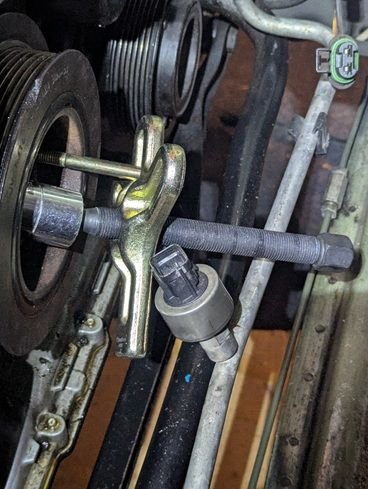

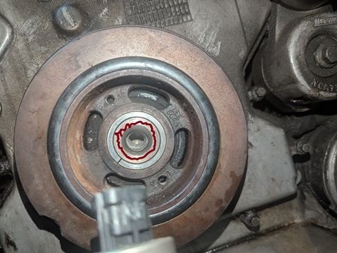

When you are pulling out the crankshaft pully do you want to put pressure on what I have as the red squiggly lines or the happy face past the threads. i put some pressure on the squiggly lines and it did not budge and I got a bit nervous i may brake something.

Full disclosure: I haven't done this on the XK.
Your smiley face looks to be hiding at the bottom of the thread where the crank bolt fits, and the red spaghetti is on the machined end of the crank.You can apply pressure to either, although I'd be tempted to put a socket between the puller and the crank end to avoid any damage to the thread in the crank.
You've done the worst part by getting the old bolt out. The sticking is due to the tapered split collar (between the crank and the inner diameter of the damper) gripping the end of the crank. I'd try applying some pressure, then hitting the puller screw head. Alternatively, some have suggested tapping the inner of the damper back towards the engine to crack the split collar loose.
Note that there's a sealing ring (XR81139) behind the damper in addition to the timing cover crank oil seal. It appears to be an unremarkable (other than the price!) 'O' ring:
https://parts.jaguarlandroverclassic...ling-ring.html
Be careful if you're using the two screw holes in the damper to attach the puller. If the bolts are too long, they can hit the timing cover and crack it.
Hope this doesn't come across like a lecture. Good luck - persevere and the damper will come off

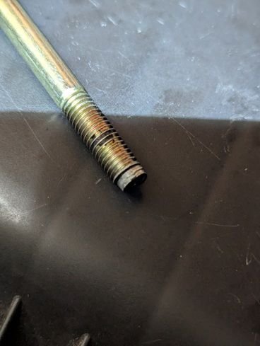

I just rounded out my second set of bolts trying to get the pully off. I hate to hit the pully to hard, i don't want to dent it.
I almost feels like the 2 hold down bolts and the primary pully bolt are working against each other.
I was not expecting this to be one of the hardest parts.
