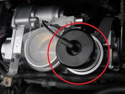

Hey folks
Quick question. What is the name of the metal (on my 1997 XK8) cylindrical part on the top middle of the engine, closest to the cabin, with the vacuum hose coming out of it.
What does it do?
Thanks
Nick

Sounds like the cruise control servo doodad on top of the TB, which, I believe, was metal rather than plastic on the early cars. Is this what you mean?:
Described as a 'vacuum actuator', but not shown as a separate part in JEPC.
Part of the cruise control if you have it, otherwise it does nothing.

If your vacuum actuator is not the later black plastic unit and it is still functioning properly, you have a RARE first edition AJ26 throttle assy. Congrats on the accomplishment!!!
I replaced DOZENS in the late 1990s and early 2000s. Many never made it through the RECALL era.
bob

That's the part! And it is the rare AJ26 throttle assembly. Still purring...
