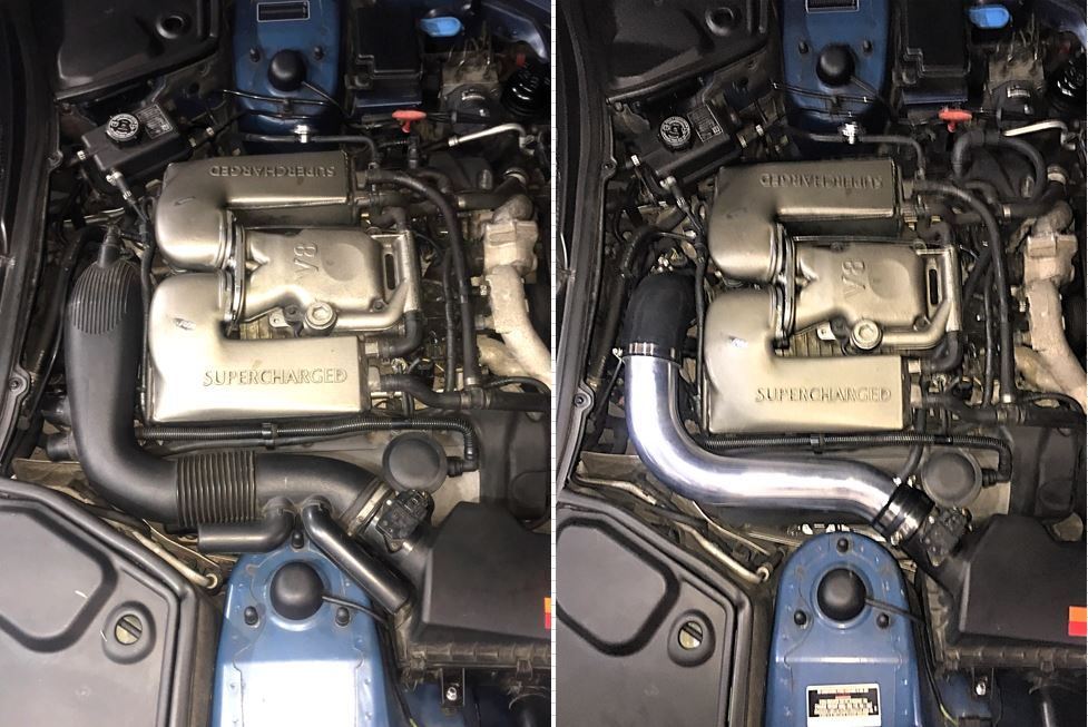

Hi,
I am considering purchasing the performance air intake and air filter combo from jaguarxpocom on Ebay for my 02 XKR100. The price is $299 (plus shipping) which seems very reasonable.
I saw something like this attached to an 02 XJR this summer and it looked beautiful. Aesthetics aside, does it really do much for the performance of the car? Anyone had any problems with this upgrade?
Jaguar XKR Performance Air Intake Tube and Filter combo package | eBay
Having done some research, it seems like a new supercharger pulley is the best bang for buck performance wise. Anyone have experience with that upgrade? Good bad ugly?
Should I go for all three? If so, does anyone have a recommended supplier?
Thanks for any and all input.
Kip

The polished intake tube definitely looks good, IMO and may improve airflow slightly, although could be more noisy absent the resonators.
...but why, oh why, stick an air filter on the end which will draw in all that hot air from the engine bay-especially on the R?? Heck, if inbound air temp didn't matter there would be no need for the intercoolers.
Smaller S/C pulley is a better option. Several on here have done this.

The laws of physics would point out that a metal system (good heat transfer-unwanted!), taking its suction from inside the hot engine compartment is at a disadvantage when versus a plastic system (heat transfer poor- helpful!) that takes its suction from a cold air source outside the engine compartment.
Looking the business is not the same as doing the business

I agree with Michaelh, removing the cold air intake will prove adverse to performance.
I fitted the same intake pipe as your advert (sourced from Mina Gallery) but kept the factory air box.
I'm unsure if there is any extra performance. It may be just 1 or 2% !! I have no data to share..
The supercharger sound is more prominant which I much prefer !!
I decided not to fit the smaller Pulley upgrade as my engine has already done 105,000 miles and I wouldn't feel comfortable putting it under the extra stress. Car is quick enough for me anyway !

I installed the Mina Gallery aluminum intake tube kit in April 2019 on my wife's 2006 XK8 after the OEM plastic replacement intake tube I had installed in October 2012 developed the infamous cracks in its accordion section, just as the original factory one had done. The Mina Gallery aluminum intake tube kit is a great product and solves the incessant cracking problem with ALL of the OEM plastic ones....

I also installed the Mina air intake tube on my 1997 XK8 as I had the same problem as Jon89. The car came with a cracked plastic intake tube and after the replacement also developed a crack I decided that the price warranted never having to worry about it again. I also hooked it up to the original air box. I didn't notice an increase in power but it sure looks and sounds good.

Couple of things: the intake allows a greater volume of air (the airbox has a restrictive opening, especially on 4.0 cars); stock & aftermarket intake pull air from the same area (front fender/headlight); the smooth tube is going to allow a less turbulence for quicker throttle response and high RPM power; heat soak of aluminum piping would only be an issue in stop and go as the cool air from a moving car is cooling the intake tubing (ceramic header coating would eliminate heat soak and look OEM); and above all the intercoolers have a bigger effect than the temperature of ambient air being pulled in. The 12whp claimed sounds about right for an R, probably a fraction of that on an 8. The intake likely would make a few extra hp on cars running higher boost levels. So this would not be a part on its own to make a drastic change, but a component to work with other components for better efficiency.

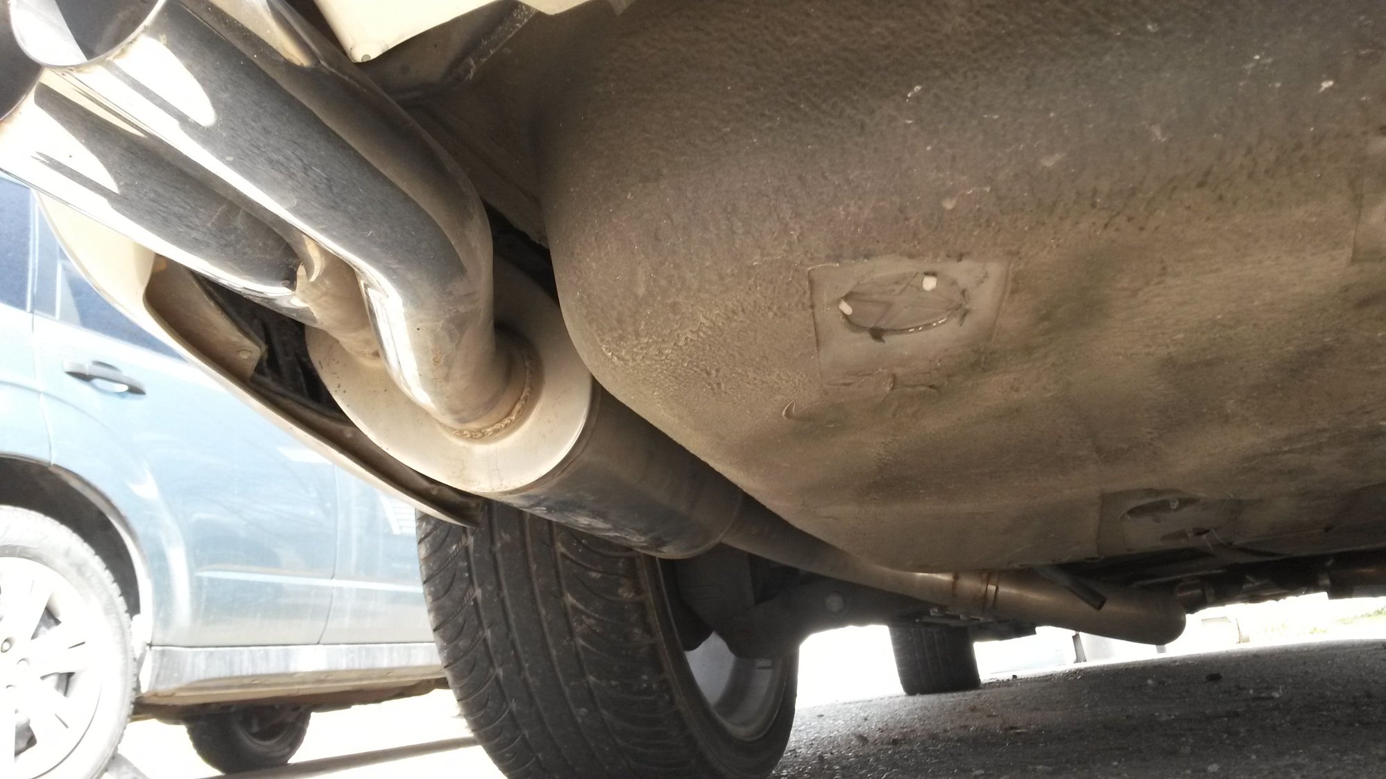

If you do intake and pulley swap, consider replacing the crushed section of the over axle exhaust (about 2" diameter) with a full 2.25" piece to match the rest of the system.

To White Outs point I noticed a bigger boost in power when I added the Mina under axle exhaust system.

Again, the only part that really needs replacing is the crushed section/axle mufflers, the remainder of the exhaust stock has a nice design (while quiet) and there would be no additional gains unless the entire exhaust was increased to a 2.5" diameter.
