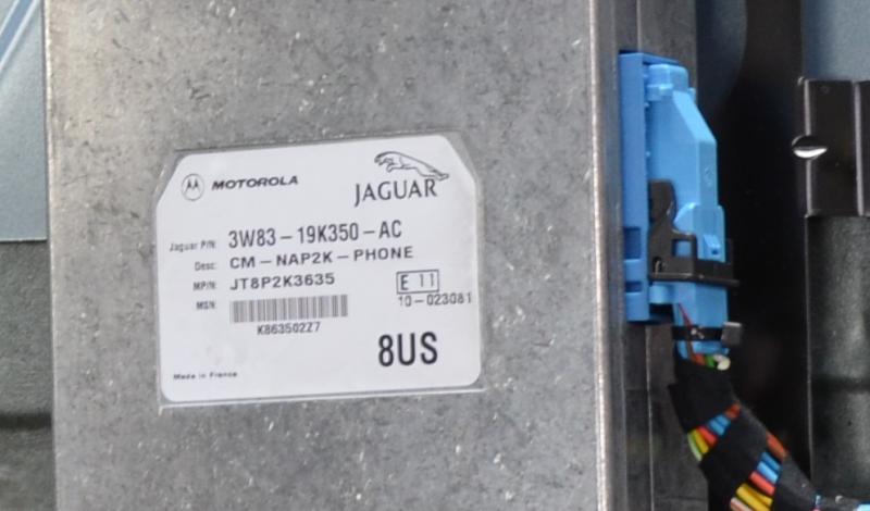

Here's the BT Module label on my 2005 showing the P/N:
You would also need an Interlink Cable.

Wow, removing the rear seat just to take a picture for a fellow member, now that is dedication!
Old Oct 27, 2012 | 10:57 AM
Likes: 17,015
Charlie,
I left it 30 minutes thinking that's what you'd gone out to do but you just didn't step up - what else could I do?
