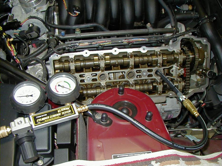

This will be interesting. I bet you will find them to have no cracks (which is not to say they shouldn't have been changed out). That really is a remarkably clean engine with 60k on the clock. My engine looked not quite so clean and the tensioners were like new at ~ 55k.
I can't prove this, but believe there is a correlation between heat and the tensioners going south.

There is also a strong correlation between heat and engine cleanliness (evidenced under the cam covers), far more than any type of oil or change intervals. This is especially true with AJ26s and the chronic problems it had with water pumps, thermostats, etc. I've plenty examples of these engines with severe coking and crystalized oil deposits built up in and around the valve train, yet owners were meticulous with oil and filter changes.
On my Jaguars and BMW I change oil only once every 12K miles with one or two interim filter changes. Attachd is a pic of the engine in my XK8. I have a pic of an 01 XKr with same mielage as mine (I was unable to download it for some reason). The valve train is in terrible shape, and the owner changed oil and filter over twice as often as I did, but he had engine overheat problems on several occasions.

Thanks, Steve. I never really understood the nature of those deposits that are seen in an engine that has lived life on the hot side. I had sort of dimly perceived that they were heat related, but that was about it.
