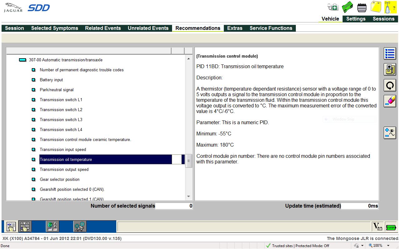

Default PID for Transmission oil temperature found?
If this is all you need, you gearheads/electronic gurus can surely figure it out based on the min/max setting and the voltage output.
Hope someone tests and uploads the proper PID equation for everyone's use in Torque.
Attached Thumbnails PID for Transmission oil temperature found?-p360607290.jpg
