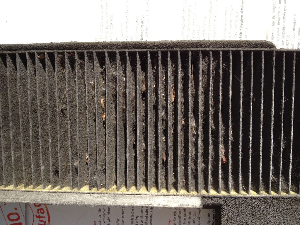

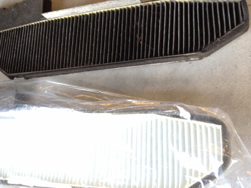

When buying service parts for my 100k service, I also bought a pollen filter, only to read, in several threads, that such a filter might not be fitted to my 2003 MY XKR Convertible.
Since I had felt my blower beeing weaker than I would expect, and having an annoying whine at level 3 and above, I decided to just dig in and see if there was a filter there or not. Lo and behold, there was. And it was far from pristine.
I first tried to remove the wipers without a puller - I can NOT recommend this. At first I tried without, but after half an hour of pulling, wiggling, prepping with corrosion eater and penetrating oils, I gave up and went to buy myself the puller. With the 2-jaw puller, they snapped off in a second.
With a sharp eye, you *may* be able to discern the new filter from the old.

Did you have birds nesting in there?
No, but a cute little squirrel family. I carefully moved them to the air intake filter.
Old Mar 8, 2013 | 05:50 AM
Very considerate. They'll have the whole Inlet Trunk to play in now.
