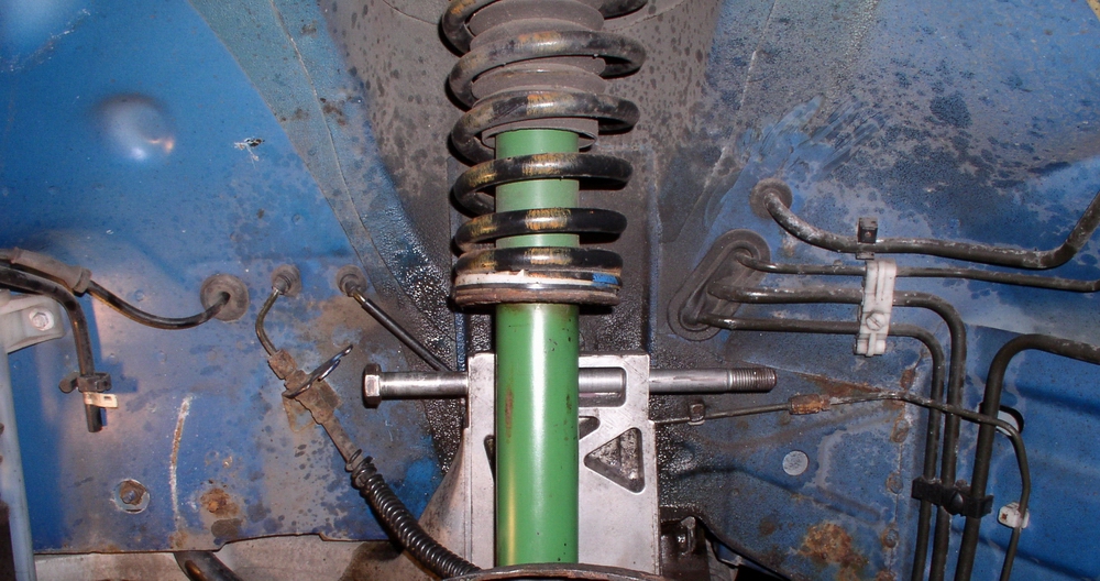

Hi guys the nightmare continues I've been trying to cut
Bolt with small angle grinder but can't cut deep enough
Maybe I'm being stupid can you tell me the method you
Have used I've uploaded some pictures so you can see
Where I'm at also I'm concerned about pipe work
Running behind bolt
Old Apr 13, 2017 | 06:08 PM
Likes: 17,005
You'll have a lot more room to manoeuvre if you remove the wing liner:
Also the section you can see inside the crossmember is the fulcrum bolt - it's not a sleeve. It can be cut with the shock absorber out of the way.

Thanks Graham think I was having a bit of a blonde moment I should be able to turn the bolt and cut through
The other side think I may need to get new shims as well
Don't understand how washers effect the camber though
Heading out there soon I let you now how I get on

hl jack l managed to cut threw bolt on the thread end lnside the wish bone rotating bolt
after each cut that allowed me to nock bolt towards the front of the car it came to a stop
drawing it back slightly l noticed some burs on the shaft of the bolt of to b&q picked up
a set of grinding bits that go in a drill like using a dremmal ground of burs and it slipped straight out
