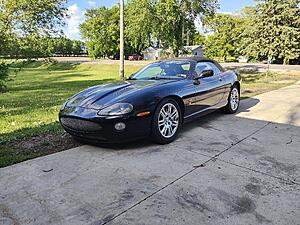

(Picture is my car, just because I think it's beautiful and worth showing off &#128513
