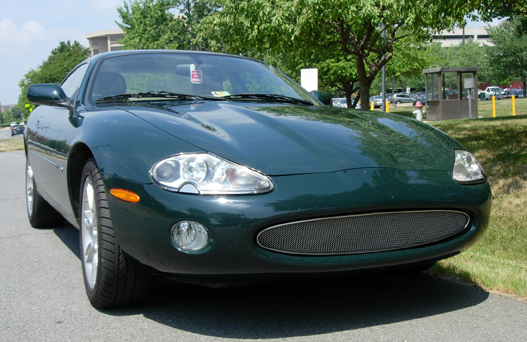

XKRacer, thanks for the info. I did pretty close to what you explained with my XK8 (see pic). Markman mentioned moving the aluminum bumper back and in his picture it appears that he retained the bumperettes. The picture of Jaxkr's car looks like it has the bumperettes as well. I'm trying to figure out if there is a way to move the whole bumper including the bumperettes back as markman indicated in his post.
