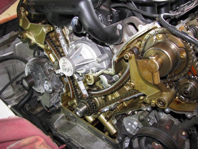

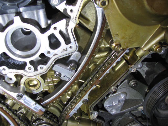

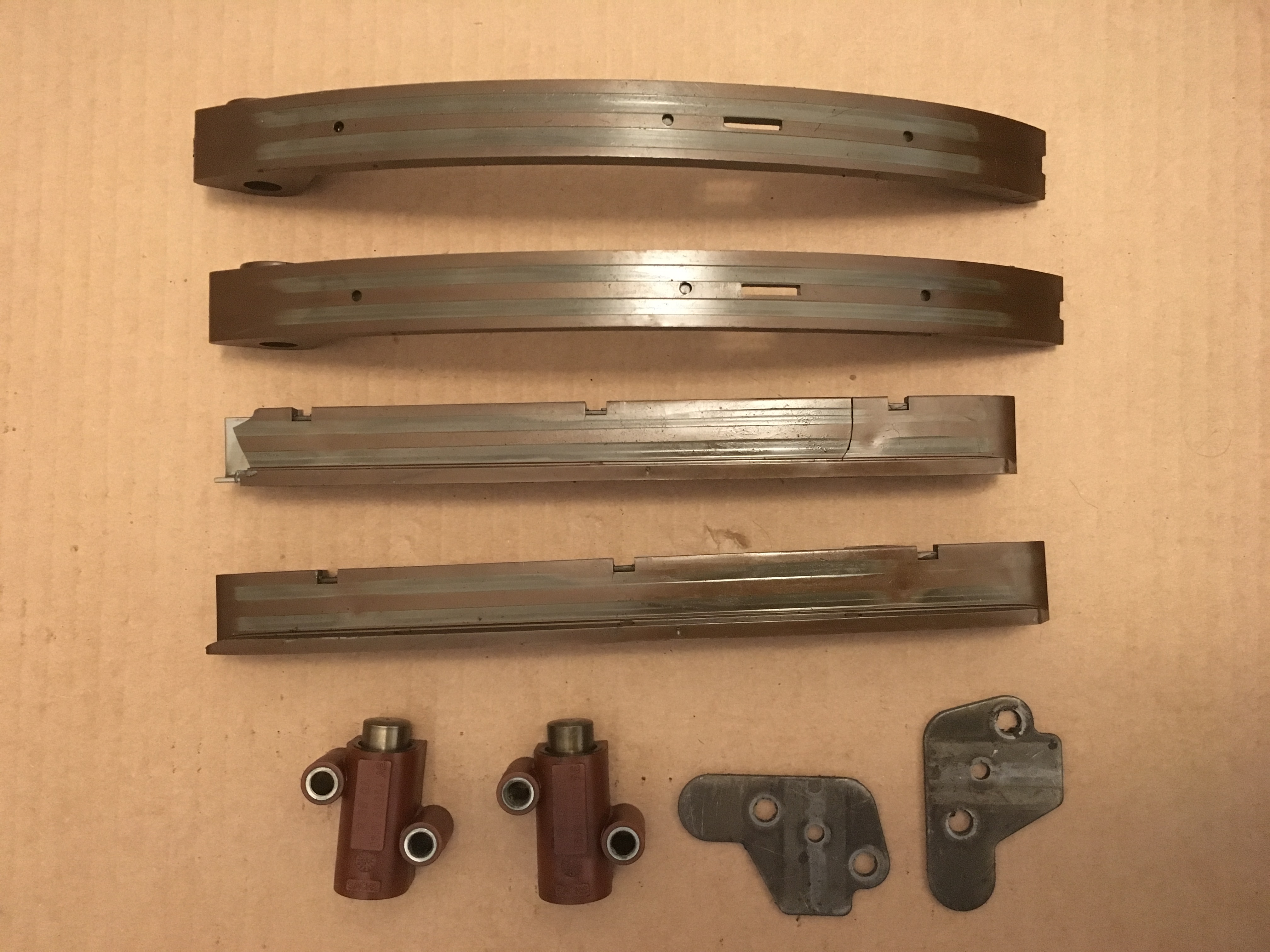

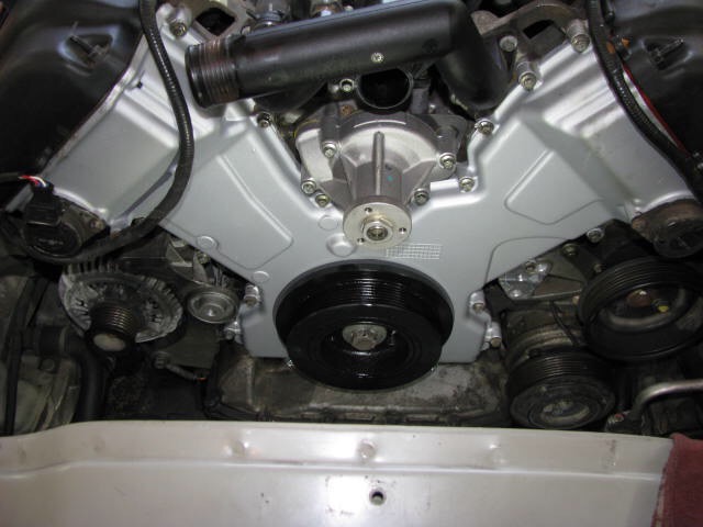

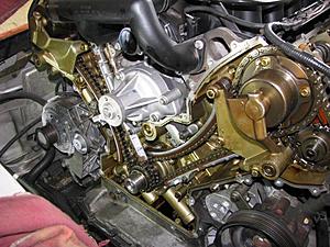

Just had my plastic timing parts replaced on my 1998 Jaguar Xk8...I bought the whole kit, in which, he charged me: $1,200 for this kit, which included the chains, primary tensioners, secondary tensioners and guides. Also, the Harmonic Balancer/Crankshaft Pulley was replaced with a used one for $400 and a new water pump ($200). He took pictures of the what he replaced and gave me the old parts. I thought he was going to replace the whole timing kit that I bought, but when I got there, he said the timing chains where in mint shape, so he didn't replace them. The total for the whole job was: $2,840 and the car rides good!
As shown below, are pictures of the engine shown what was replaced; and the old plastic parts that he replaced... My question is: From the pictures below, it looks like I have to tensioners that where not replaced -Is this a big deal???
Thanks, Art
Thanks, Art

Regardless of condition, he should have changed the primary timing chains for the new ones while he was in there. That's a complete no-brainer.
Is he going to shoulder the cost now if a chain breaks? I doubt it very much.

The main point of the whole project is to change the secondary tensioners. They will fail, just a question of when, and may destroy the engine. He not only overcharged you for the parts, but the secondaries still have to be replaced at the very least. You might get by without changing the chains, and if they're of unknown quality that may be a good decision.
You either need to do the secondaries yourself, a easy enough job using the zip tie method found on the forum, or find a competent mechanic.
They only need to fail once!
Seriously, do a forum search on secondary tensioners. Changing these out is one of the most important PM jobs you can do.
The plastic parts are white when new: they turn red/brown in service.

Your mechanic seems to have done the opposite of what is required as a bare minimum - which is to change the upper (secondary) tensioners and leave everything else. Instead of changing these, he has changed the other tensioners.
If I were you I would be going back to him and ask him what he is going to do to correct the situation as you have paid him to do a certain job and he simply hasn't done it.
What I can't understand is that he already had the breast plate and pulley off to expose the timing gear. Changing the primary chains from there is a 5 minute job at the most. With the tensioners removed it's a simple case of just slipping the chains off and putting the new ones on.
It's got me thinking that he didn't use any timing tools to do the job, and was scared that if he removed the chains the cams would slip round and he wouldn't be able to re-time it.
The more I think about it, the more I'm certain that that is what he's done.
Plus, if you think about how the secondary chain is replaced, by having the cam gears off, then in my mind it becomes more or less a certainty.

Spark plugs also much cheaper on ebay. But the plugs are usually good for 75K+ mi. The bolt will have to come from a online source like merriamparts or SNG Barrett, unless a member takes pity on you and sends one from a parts car.
You should contact SNG Battett via the ad on the forum and request the free XK8 parts catalog. It's very handy for determining part numbers and their prices are competitive.
