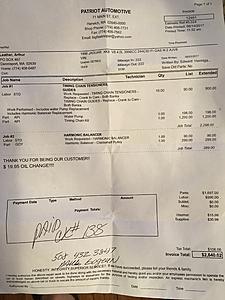

In my option, he 'most likely' did a good job with what he replaced, but didn't have the timing tools to lock the cams in place to change the chains and didn't realize that changing the secondary tensioners, you don't need to lock the cams in place.
He had my car for two weeks and just wanted to be finished and get paid. So, he never let on about not changing the secondary tensioners and the next day I drove to New Jersey and back to Cape Cod (approx 600 miles) before I looked at the old parts and pictures he took; and posted the post on this forum, that lead me to do the rest of the job myself.

Michaelh; Wasn't there was some metal to metal action taking place within the primary chains, when you look at the old parts I got back (below)???: But even through, I think the chains are ok - I hope :-)

Just spotted the missing piece on the chain guide 3rd down in your pic. I don't see any evidence of metal-to-metal contact on the edge, although is that a tiny piece of metal bent up on one side at the end of the groove? They're probably the least broken up set I've seen posted here, but they're much better in your dustbin rather than the car
The secondary tensioners haven't lost their plastic shoes, so that's something you won't find in your sump. The drunken one looks as if it was ready to keel over and put you into a world of pain.
You'll likely be worrying about the missing piece(s) - it will do no harm to drop the sump and check for debris either in there or in the oil pump strainer. For the sake of a gasket and a bit of extra effort, I would.
