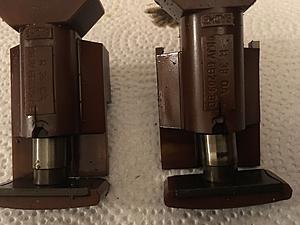

I just replaced both secondary tensioners with the metal ones and it looks like I was driving a time bomb that was just about to go off!!! Below is a picture of the old plastic tensioners. I will finish job tomorrow. Hopefully the car will start right up and purr like a car... LOL <GRIN>

EZDRVER Your old plastic tensioners shows a spring on the piston and mine didn't have a spring on the piston - What is up with that??? Maybe it's because your car is a 2000 and mine is a 1998?

And that just goes to show how **** poor that mechanic was.
Is it the picture, or are one of those tensioners a bit sqiew-iff?
Jaguar added a spring in the tensioner to "upgrade" it, basically it was supposed to get rid of the death rattle, in the second gen tensioners.
If you have no spring then quite possibly you had the 1st gen lot.
Now you've tackled that job, wasn't so hard now was it.................
