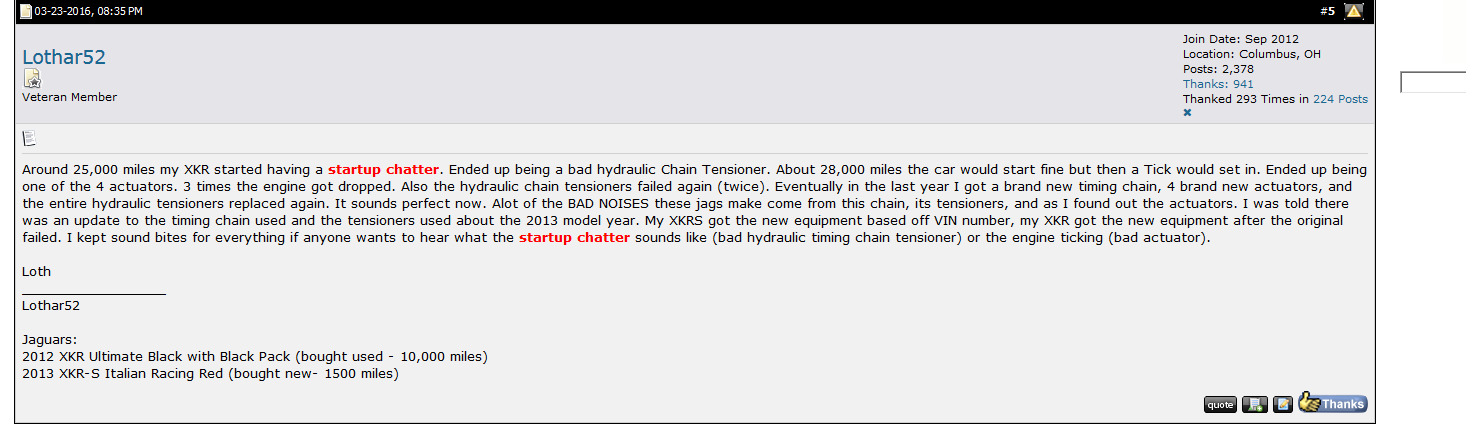

[QUOTE=Stamford;1625095]I have not heard of any 3rd gen tensioners failing. I'd be willing to bet a bundle that Razorboy's noise is the VVT units (as is my noise). If it were the tensioners and he has continued driving, by now they would probably have failed completely and his engine could well be toast. His sound does not seem to have gotten worse, so I really think that rules out tensioners. I've lived with my noise for over two years and it has not changed. Only happens when my engine has sat overnight or more than a few hours, and even then not always. I'm so used to it, I really don't even note it anymore.[/QUOT
Something new for you
AGCO Automotive Repair Service - Baton Rouge, LA - Detailed Auto Topics - Timing Chain Problems II
A short extract of the link:
"One of the more common symptoms of a worn timing chain is noise, especially on startup. A rattling noise coming from the engine may show a seriously worn timing chain. Slack in the chain allows it to strike the timing cover. This may produce debris, worn from the timing cover or produce a hole in the cover and a serious oil leak.
Ford modular V-8 engines, such as the 4.6, 5.0 and 5.4 liter seem to have a particular problem with this. After a few seconds, the tensioners tighten the chains and the noise stops. Lack of the noise after running, does not suggest the lack of a problem. The tensioners are masking the noise. "
Even 5.0l tensioners fail.
From post 15 in this thread : 5.0l cam chain tensioner problem - Page 2
"I don't think the 5.0 tensioners have the same level of issue that the 4.0 engines had - basically, if your original 4.0 tensioners haven't failed, they're going to. But a couple of people on the US forum have had tensioner issues on the 5.0 cars; they're hydraulic tensioners, so they have a ratchet mechanism to keep them taut when there's no oil pressure. In some cases the ratchet fails, so the tensioner goes loose when the car is off, and it takes a few seconds for them to pressure up when the car starts. This leads to a brief chatter from the chain until the tensioner pressurises and takes the slack out - that's the symptom that attracts attention. I guess, worst case, the chain will slip and then Bad Things happen. But this doesn't seem to be an epidemic problem like the 4.0 had."
