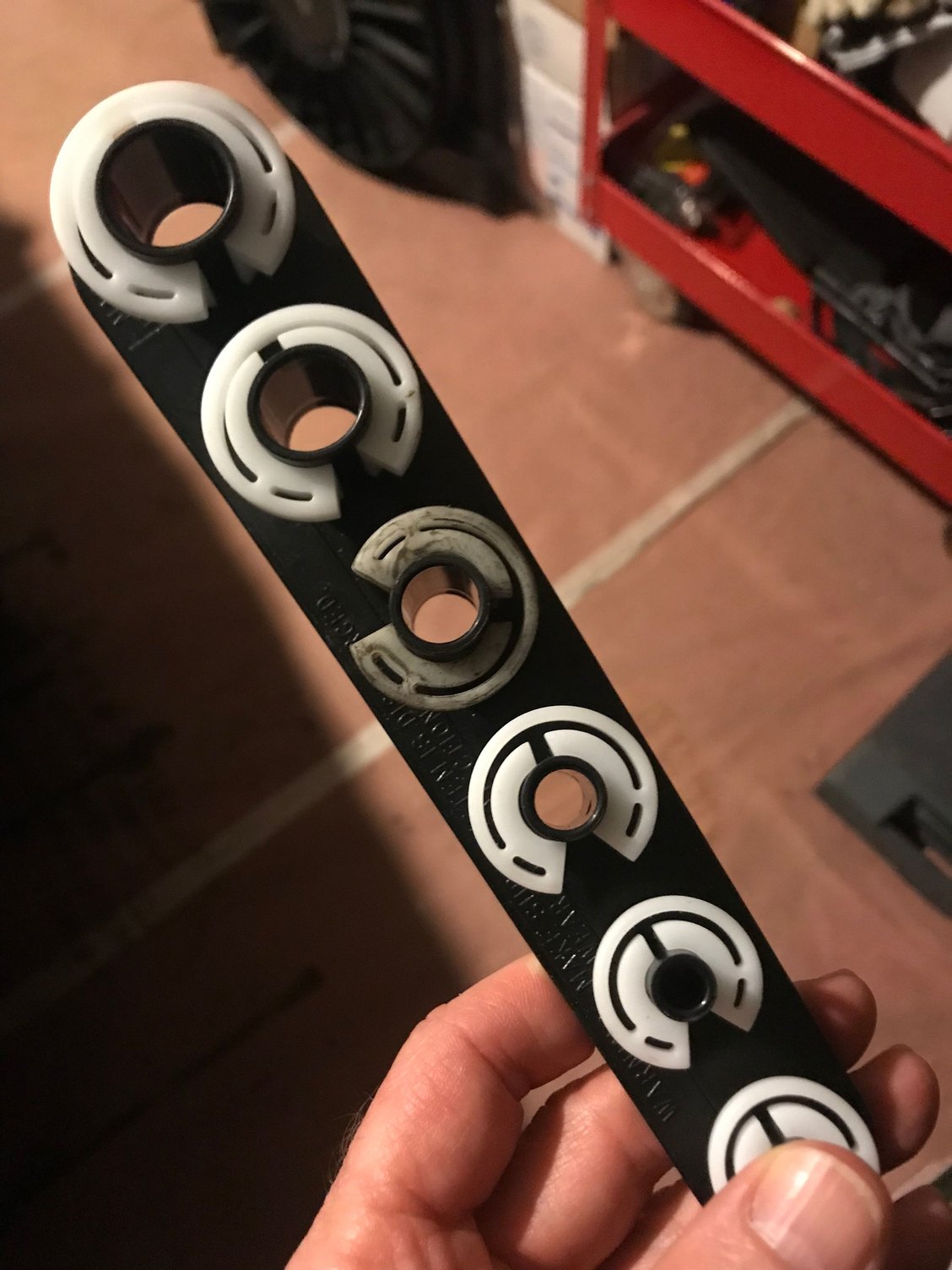

Use these ?
Old Mar 13, 2023 | 06:18 AM
RJ237's Avatar
Joined: Dec 2010
Posts: 8,837
Likes: 2,926
From: Douglasville Ga.
yes
