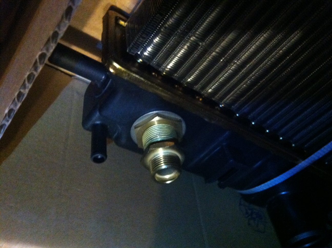

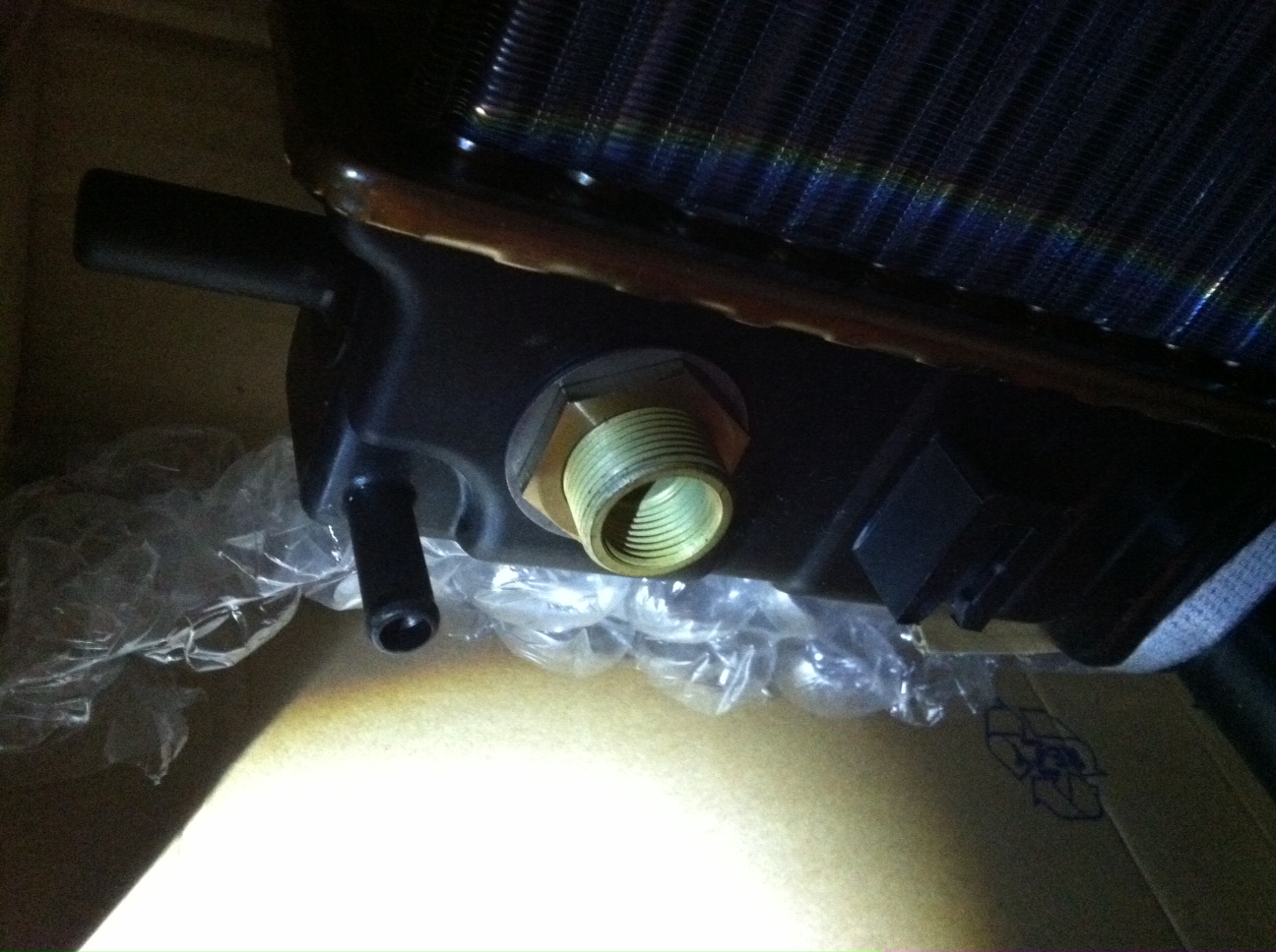

The two new ones are Nissens 61700 (which replaces MJA4190AF) and 61701 (which replaces MJB4190AF). I was told by Graham (GGG) that the suffix is often just an indicator of supplier changes. Two different Jag dealers say I need the MJB4190AF for my XK8 based on VIN#.
It appears that the two radiators I have are identical except that one has an adaptor fitted to the TOC connection (see pictures). I haven't had a chance yet to try the adaptor against the transmission line on my car, but the eyeball method says it should work.
Pictures are below. Sorry, they keep coming up sideways. I can get pictures of the entire unit(s) if you need.
