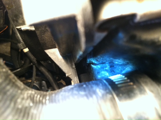

I reported in an earlier thread that I had fixed a coolant leak by replacing the top radiator hose. That lasted all of a few days and now I have coolant dripping under the nose again. After some inspection, it appears that the top of the radiator just under the top hose connection is cracked.
Where I need help is in determining what that part is made of. It is black, but I thought it was aluminum as a magnet does not stick. However, I am wondering if it might actually be plastic (yikes!). Does anyone know?
I have a friend who could easily weld it if it is aluminum, but doubt that works with plastic (maybe RTV?). Or do I give it up and buy a new radiator?
Crack is in the brightly lit portion of the picture just above the hose clamp. All suggestions appreciated.

The radiator tanks are plastic as they are on many current vehicles. They are not repairable.

Thanks test point. After closer scrutiny I realized both sides of the unit are indeed plastic. Didn't realize that was common. Guess I'm looking at a replacement then.
