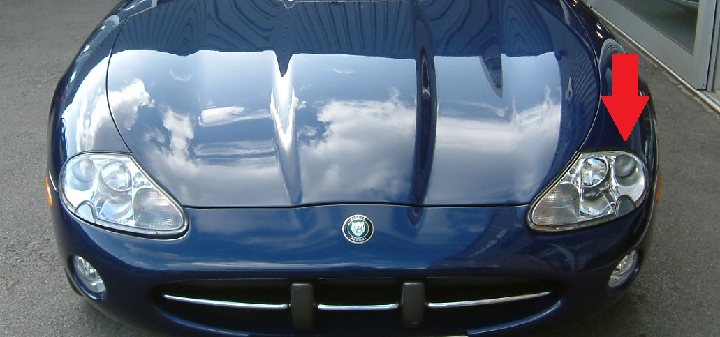

The outer driver's seat bolster is a regular wear point. However, it's usually only the leather dye scuffed off. A cut in the leather would be costly to repair but re-stitching a seam is an easy job for a upholsterer. Of course, it does require removal of the seat covering.
If I understand the location of the dent correctly, it's around the area arrowed in red?
Its going to need beating out and refinishing. The main consideration with panel repairs is being able to access from behind to knock out a dent. The black plastic wing liner can easily be removed to get to this and removal of the head light isn't difficult.
I can't comment on the asking price as values here in the UK are very different from those in the US. Nevertheless, you need to factor the cost of these repairs into the negotiations.
